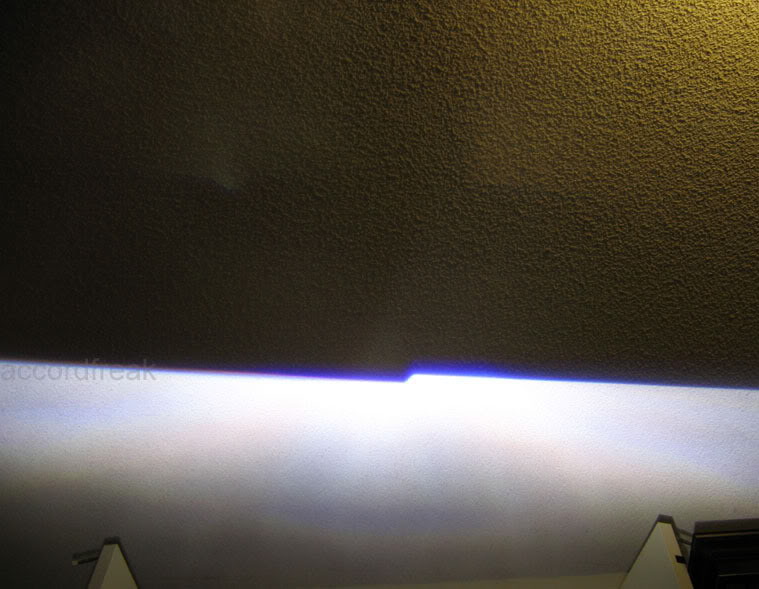

here's a picture.
Like you guys discussed, as the shield is higher, the cut off line is sharper with vibrant color but the foreground light is greatly reduced. It was really difficult finding a happy medium. I would have a sharp cut off at 20 feet but at 60 feet the cut off would be extremely blurred so I had to compensate that too.. ughh

Jun 2, 2007 | 12:03 AM
  #100
I understand. I lost some of my cutoff on my TL's but got more color so I'm still happy.

Jun 4, 2007 | 03:28 PM
  #101
because the projector is like a magnifying lens , you can only get true focus of one particular distance. a blurred cutoff at a distance is good in the sense that your eyes will be greatly strained by the high contrast as a result of the sharp cutoff. Since you are staring into the distance while driving, it's better to not have such sharp cutoff. That's why most are focused at around 25' to be sharp and it blurrs eventually in the distance. But there are cases where the projector does well in pretty sharp cutoff at most distances (S2K)
