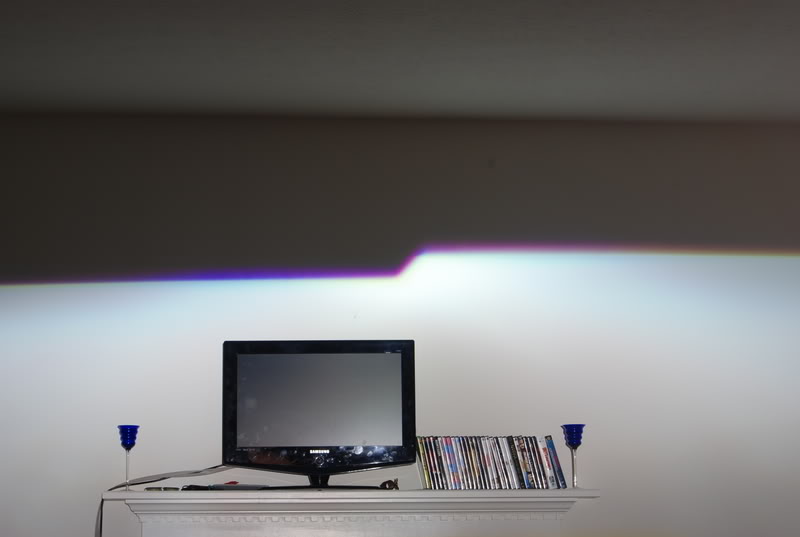

this my TL with ZKW

Mine is not quite as clean of a cut-off but there is more color. I want color like those you posted above.

color is a correlation with sharpness. If you want more color there are a few things you can do, either Push the shield towards the bowl or remove the black plastic stop on the cutoff shield.
I did remove the black stop to get the color I have. Is it possible to bend just the sides of the shield to get more color on the sides?
Yes..but you need to experiment a little bit at a time.
