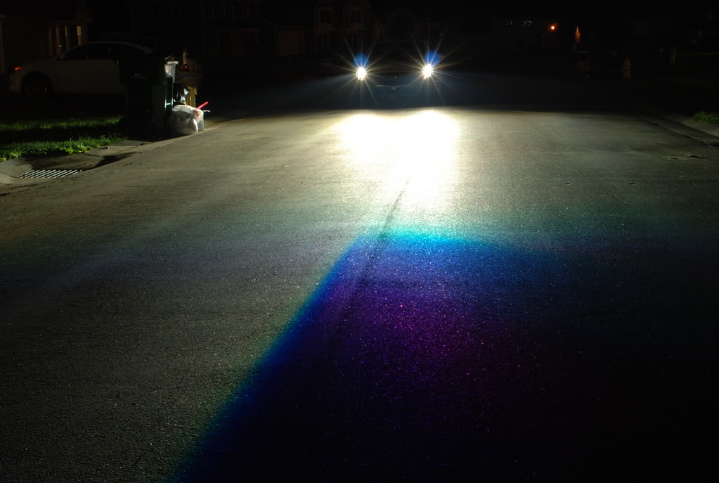

changing kelvin of the bulb only change the overall output, it does nothing for the cutoff and you most likely have no "flicker" A flicker would comprise of any number of colors of the spectrum instead of just 1. Like what you see here just above the cutoff is what colors you would see in a flicker while remaining light is still stock.
