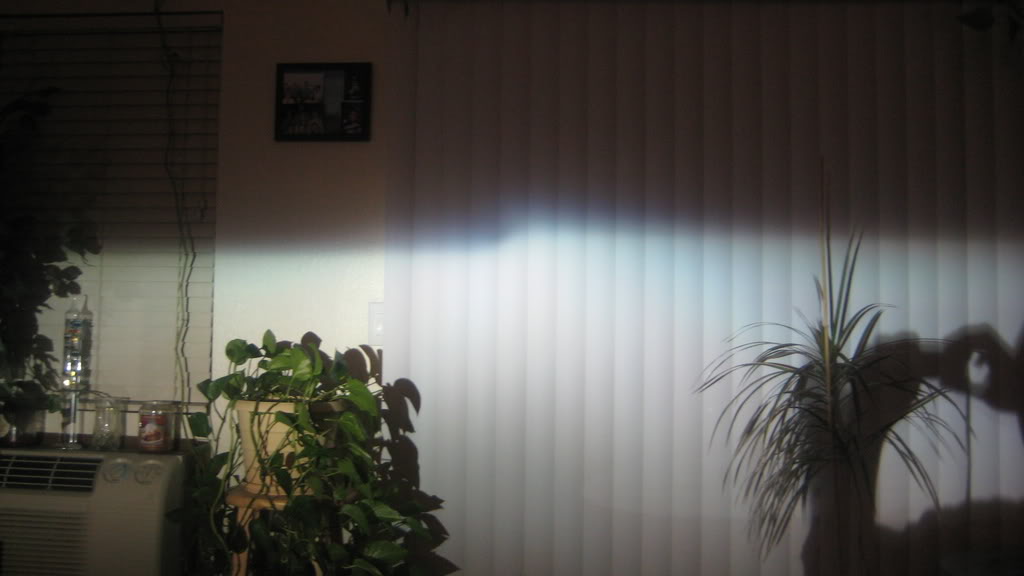

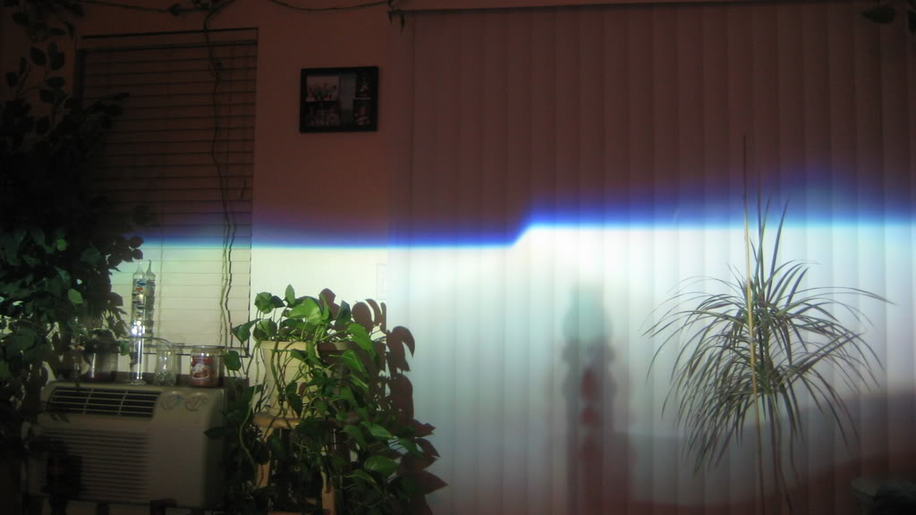

K. Here it goes. Vis and i got together today to try and experiment with Ivory's color mod. We tried following the steps as close as possible, but ended up making our own way to bend the cutoff shield, because we were not able to get the same cutoff line as shown in the previous pictures. We modified the spacer the same though. We were able to get the color across the cutoff line to range from really thick color, to almost none. The pictures are taken with the projector at about 21' away from the wall, and the camera in between. We powered the lights with a computer power supply that was picked up from a local computer shop for $10. It has the power button built on to it for easy use.
Unmodded 06 with Fresnel lenses.
Modded with clear lenses.
What do you guys think?

looks good

hard to tell but it appears to be bowing up on both ends. That is also a lot of color at that distance. I would suggest backing off of the color modding a bit at that distance so at further distances you still have some sharpness

it is bowing up on both ends. its weird. there is a straight horizontal band of color that remains horizontal as well as that bow'd part on both sides. tilting the shield forward increases the sharpness and decreases the amount of vertical displacement of the bow but the bow still exists even with a very very thin color line at the cutoff.

to get rid of the bowing. You need to either straighten out the cutoff until its flat, then space the lens out accordingly. if the lens is as far in as need be, then first curve the shield more so it appears to be a semi-circle, then push the shield back to get the sharpness and color.
