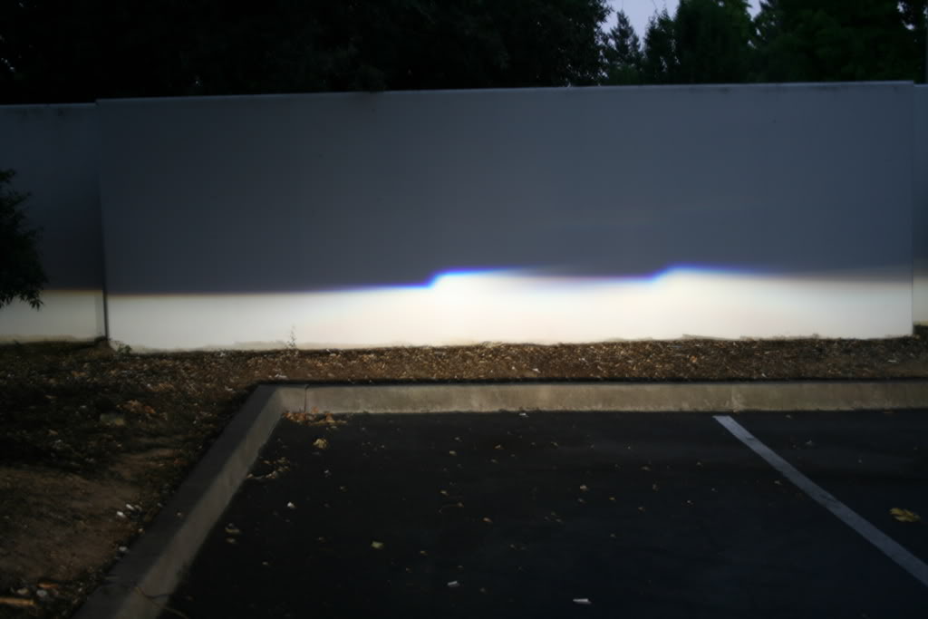

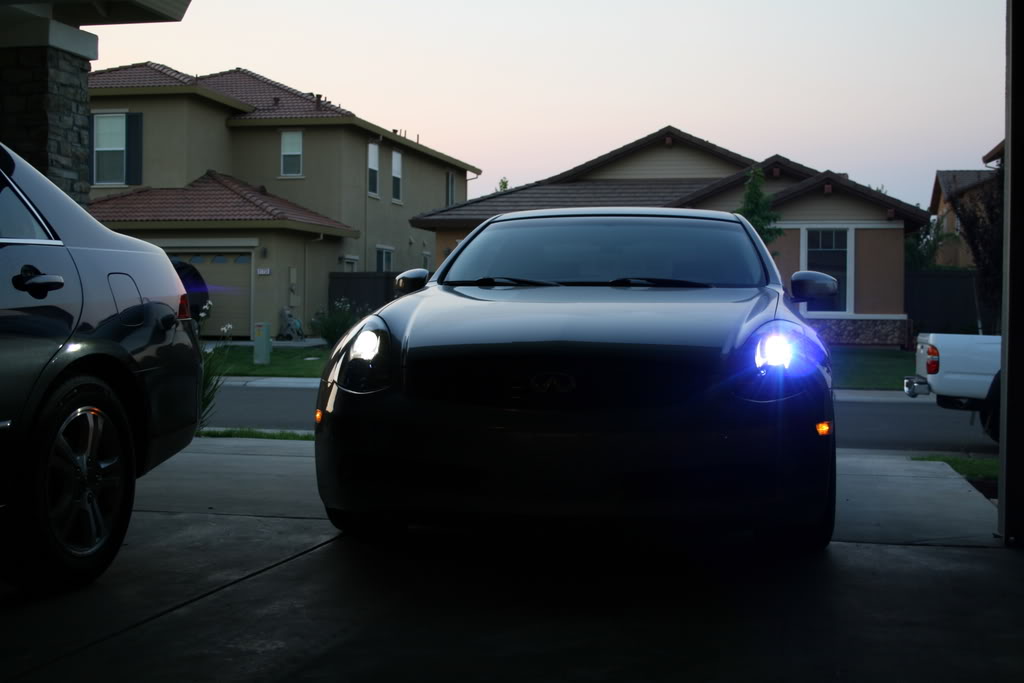

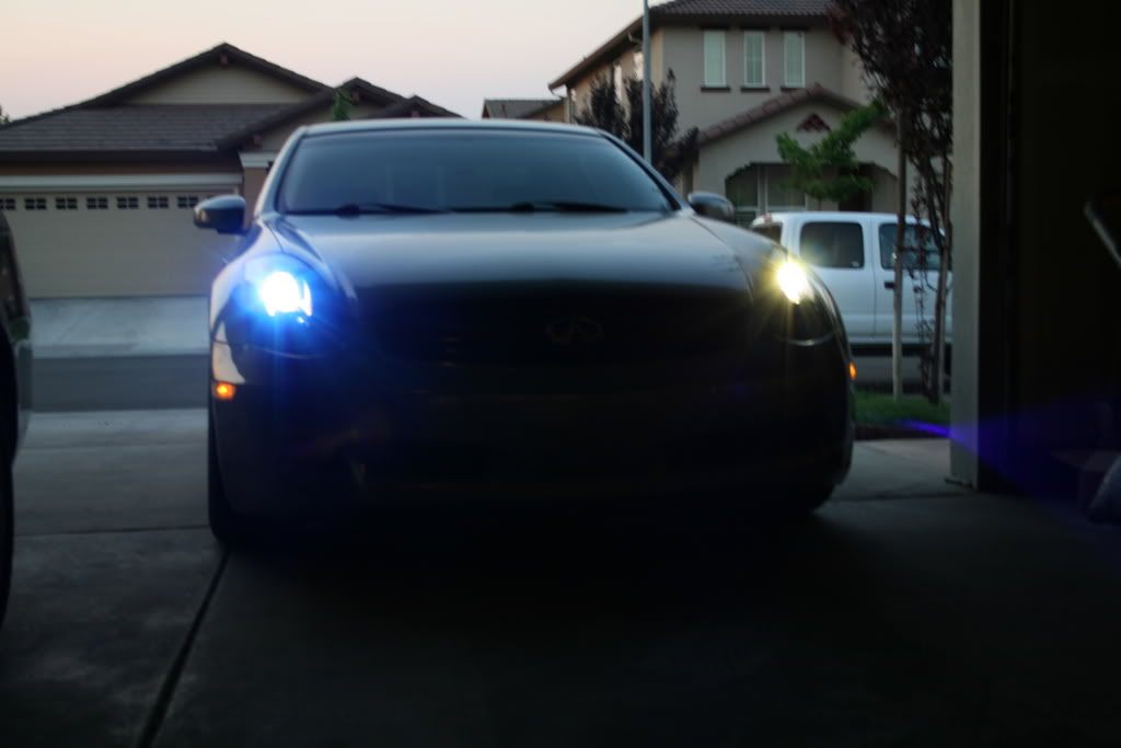

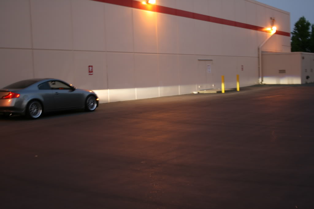

here are a couple of the pics of the results... i still need to do a few adjustments as the cutoff is slightly crooked. the cutoff is razor sharp close up, but in the cutoff pic it looks fuzzy from the distance that the pic was taken. overall, i am happy with it, much better than stock.

Old Jul 7, 2008 | 01:03 AM

Old Jul 7, 2008 | 01:17 AM
  #180
g7x5's Avatar
Joined: Nov 2006
Posts: 399
the cut offs are off some
meaning the metal thing need to bent
the cutoff should be sharp at that distance,
make the cutoff sharp at about 25' and it will be sharp further out
i had the same problem
after i messed around with the metal sheild some more
