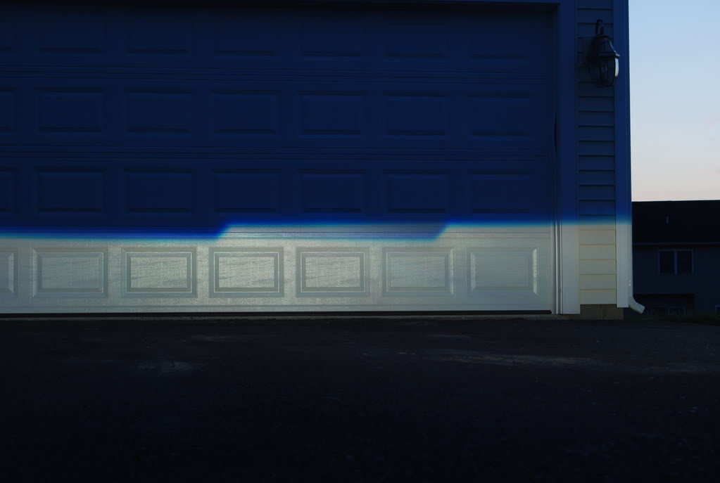

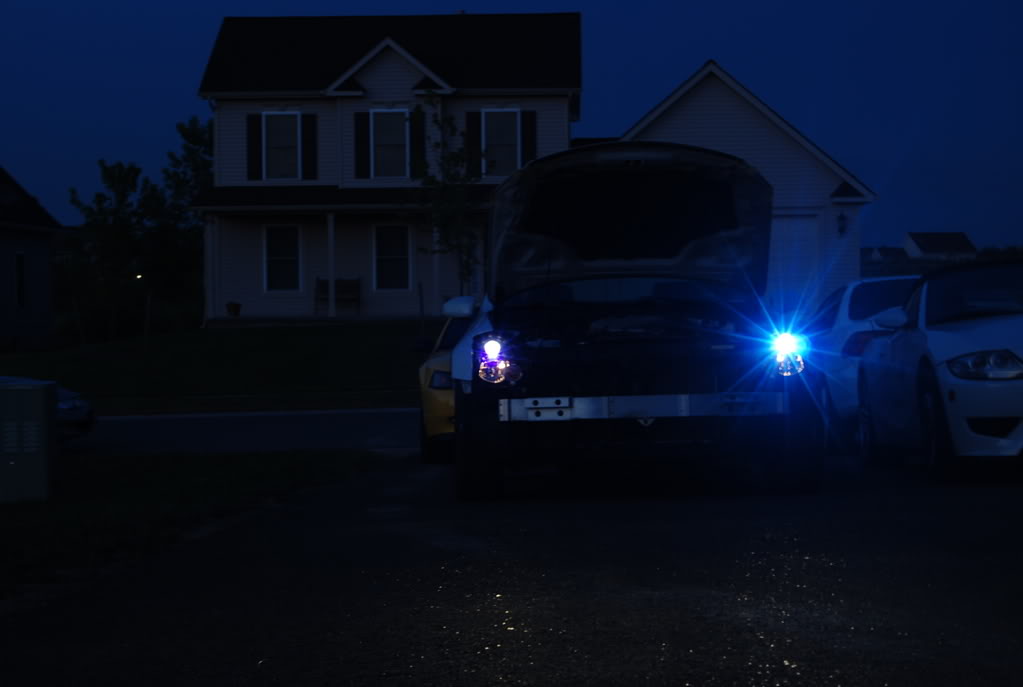

pic from my latest project

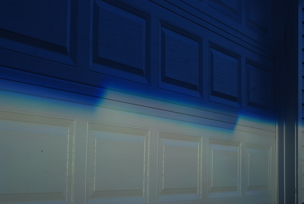

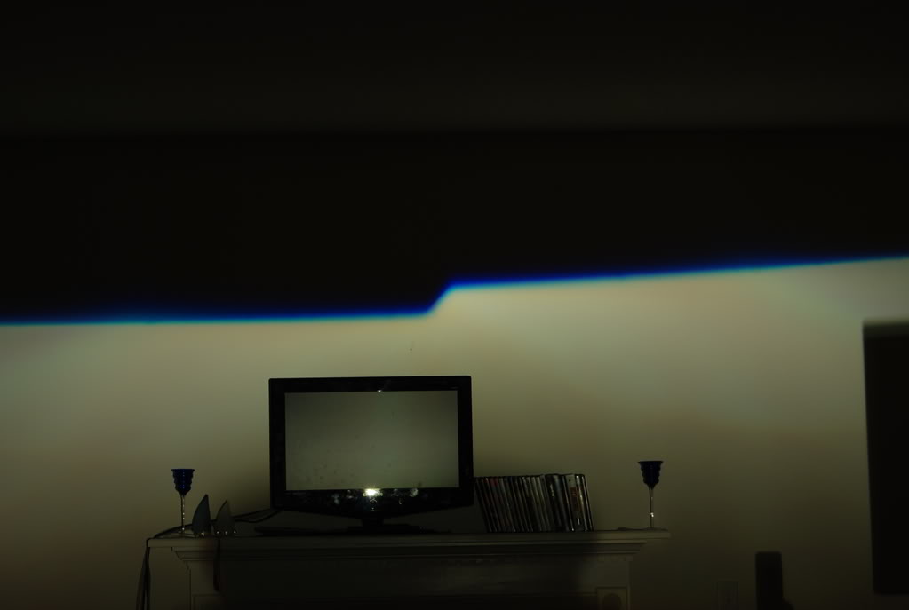

in any case...just something for the eyes...

sickness, mine didn't stick when I adjusted the holder, but I guess it depends on how you bend it. I'm guessing there is a bunch of purple above the blue also that isn't captured by the camera?
Old Jun 12, 2007 | 12:59 AM
  #134
IvoryGT's Avatar
Joined: Dec 2004
Posts: 4,212
Likes: 12
yep...there's thick purple not captured...if I get the camera to get the color in, the picture will be overexposed.
Old Jun 12, 2007 | 02:59 PM
  #135
ttrank's Avatar
Grocery getter
iTrader: (57)
Posts: 27,305
Likes: 190
From: Phoenix
How did you get the color line so even? I have a lot of color with my TL's in the center but is drops off on the sides.
