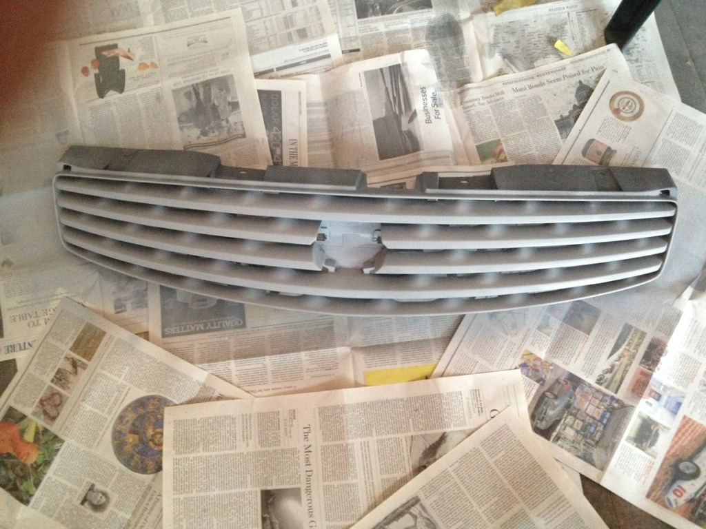

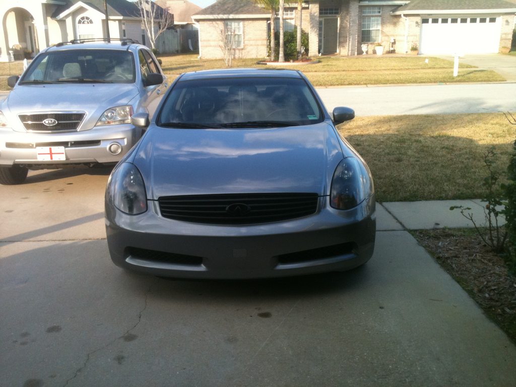

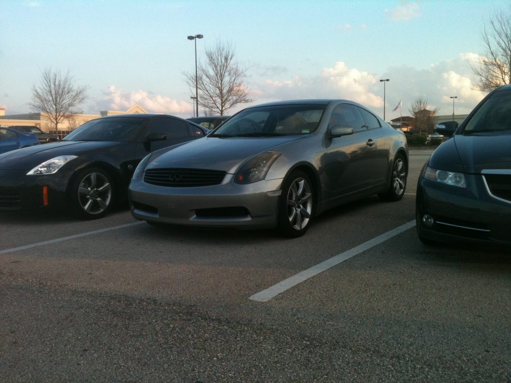

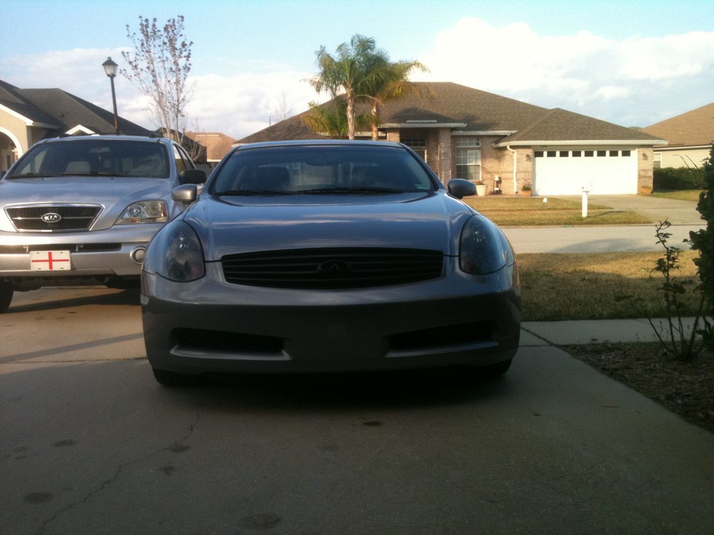

Re-did my grill today. Had too many chips and decided to paint the mt fuji too cause I got tired of the black and chrome look.
Pics:
DIY blacked-out grille w/ pics-x5nuth.jpg
DIY blacked-out grille w/ pics-fopioh.jpg

^is that flat? what process did you use and materials? i plan to do gloss but just curious
Old Feb 24, 2012 | 12:38 PM
  #273
Mark2K8's Avatar
Joined: Dec 2010
Posts: 1,244
Likes: 40
From: Jacksonville
No its actually gloss, but camera didn't pick it up well.
I sanded the grill down, used primer (duplicolor), gloss black (krylon gloss black) (this: http://s.shld.net/is/image/Sears/03006802000) and clear coat (gloss, duplicolor).

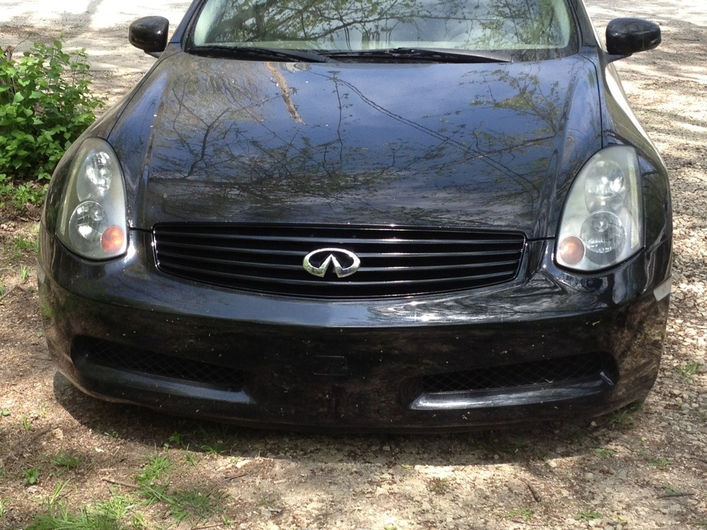

Old Mar 26, 2012 | 09:01 PM
  #275
Thats G's Avatar
Joined: Jun 2009
Posts: 121
From: Kansas City
Started mine today. Got 320 grit sand paper to sand down a few rock chips and get the chrome off. Using dupicolor primer, gloss black, and clear as well.
Did the first coat of primer after sanding and cleaning.
Just applied a second coat. I plan on wet sanding with 600 grit once its completely dry. Then I'll apply a third and wet sand again before applying the first gloss black coat.

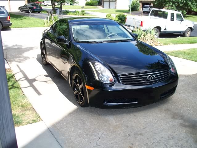

Old pic for comparison
Finished product. I think it turned out great, but I do have some doubts with how long it will be able to hold up. (sorry for posting such a dirty car lol)
