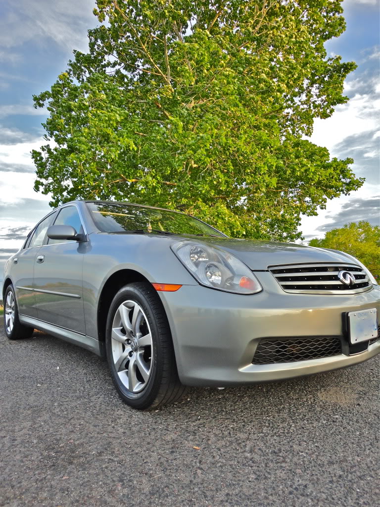

Here's my sedan. I felt like it was a nice touch to bring some more black to pull in the look of the rims.

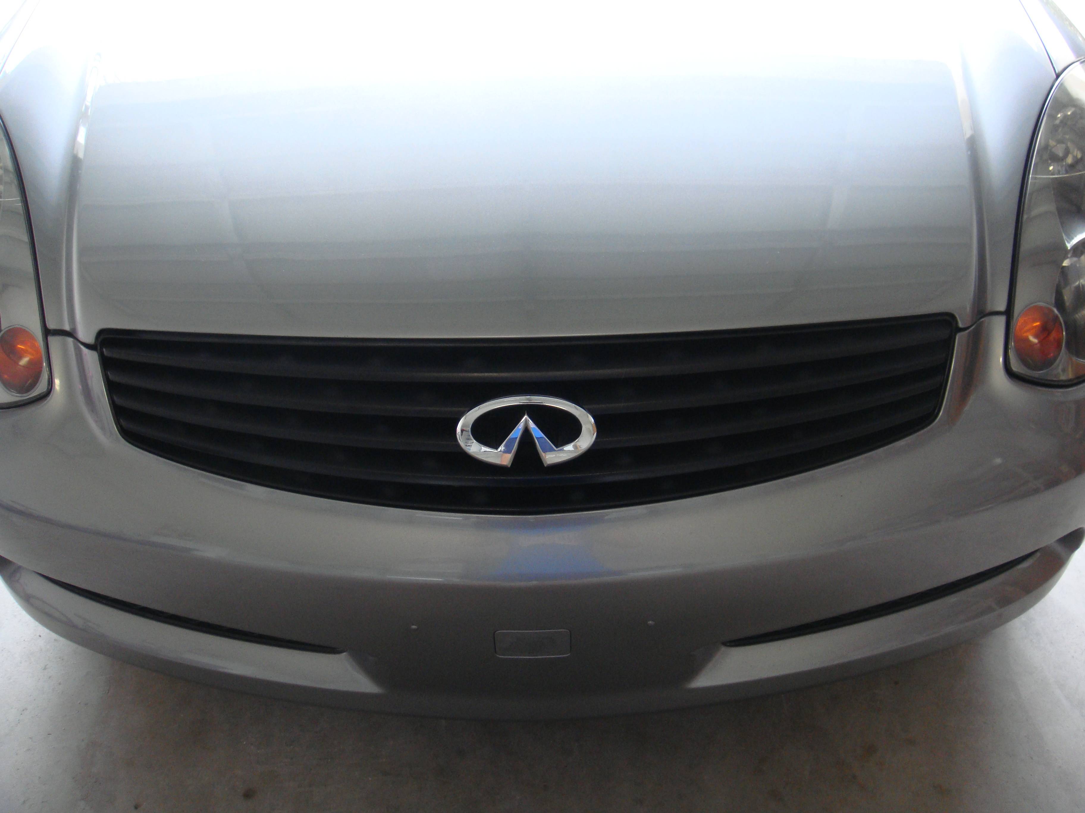

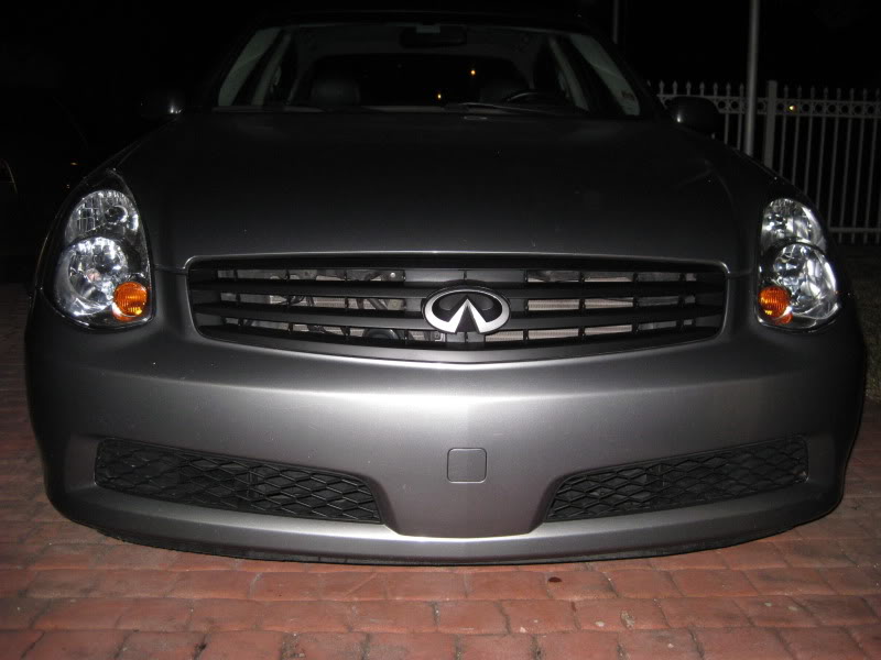

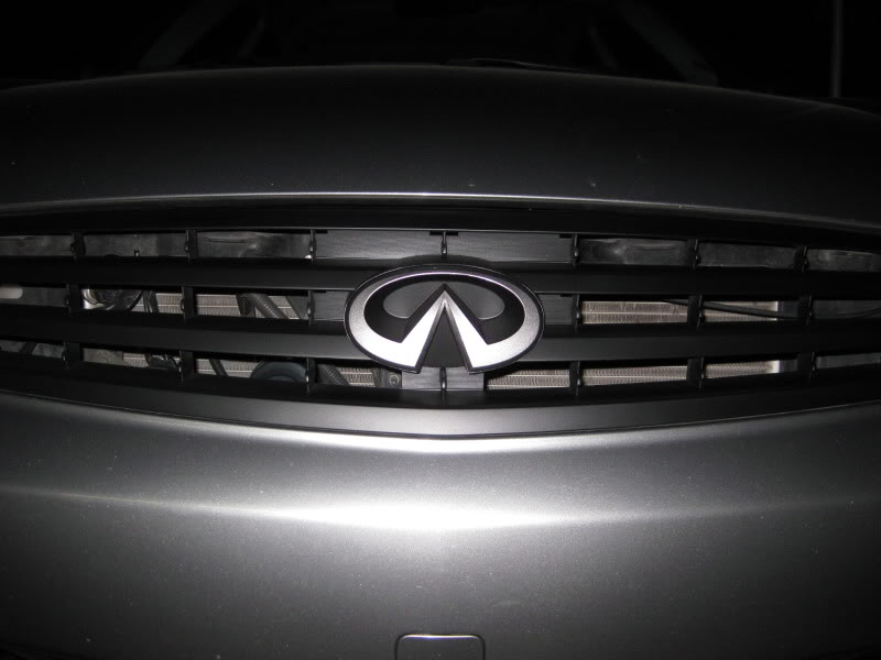

here's mine, did the grill in satin black, and the face of the emblem colormatched dg with basecoat/clearcoat, then satin black inside and all around the emblem...

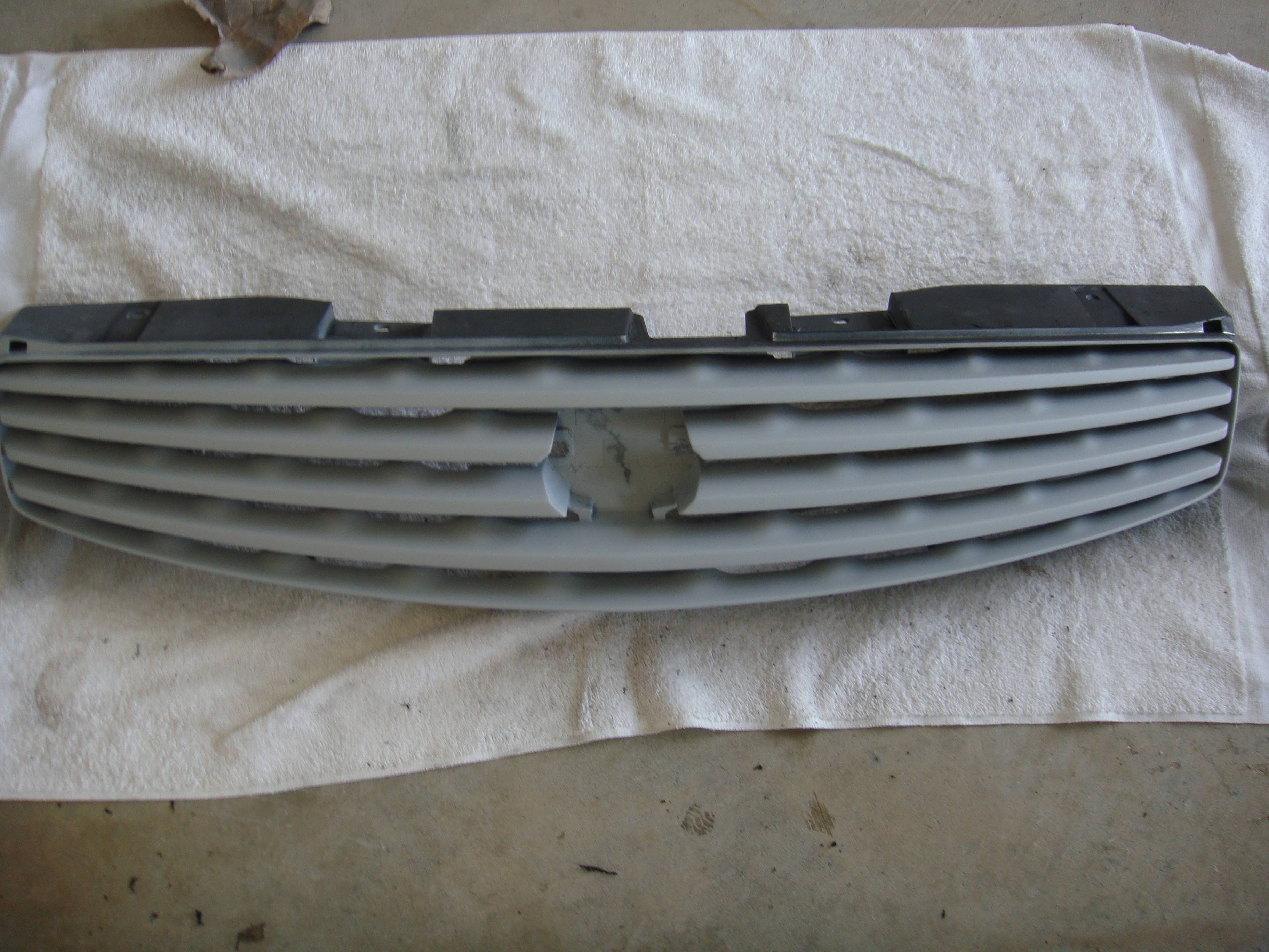

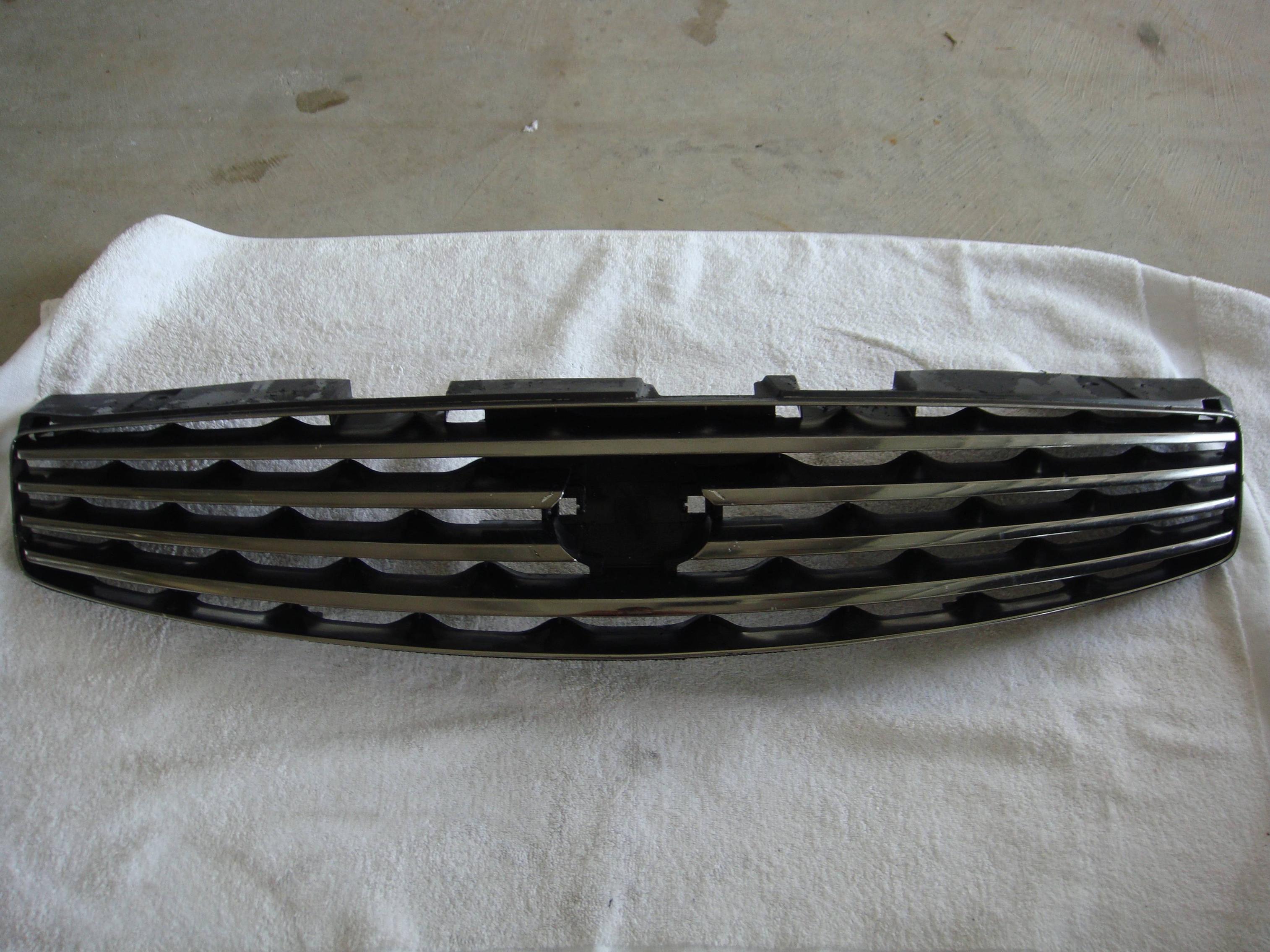

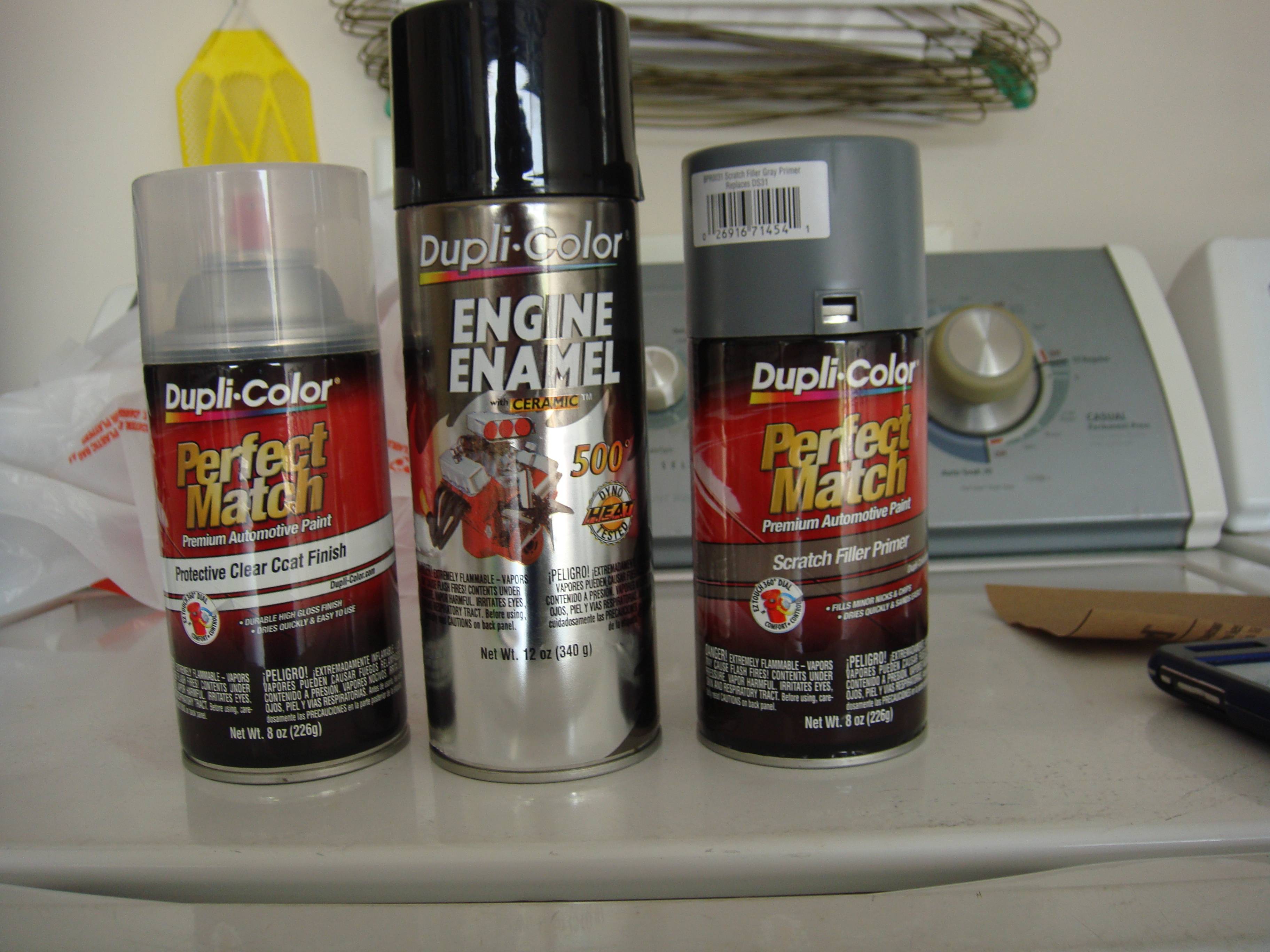

Just did mine:
Materials:
DIY blacked-out grille w/ pics-aycs1.jpg
Grill as it is. Yeah it has some chips and scratches here and there. SPent 4 hours the day before removing the plasti-dip i had on.

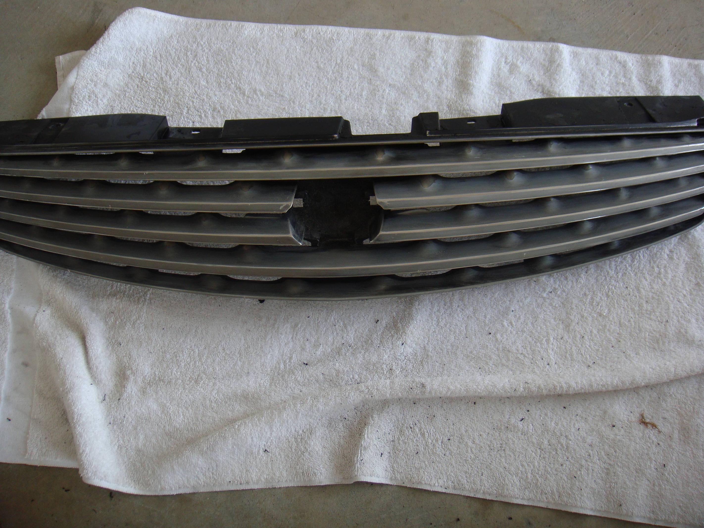

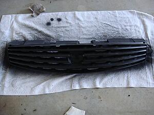

DIY blacked-out grille w/ pics-uyt94.jpg
After sanding: (used 220 grit. Spent 2 hours sanding it. Smooth as a baby's bottom

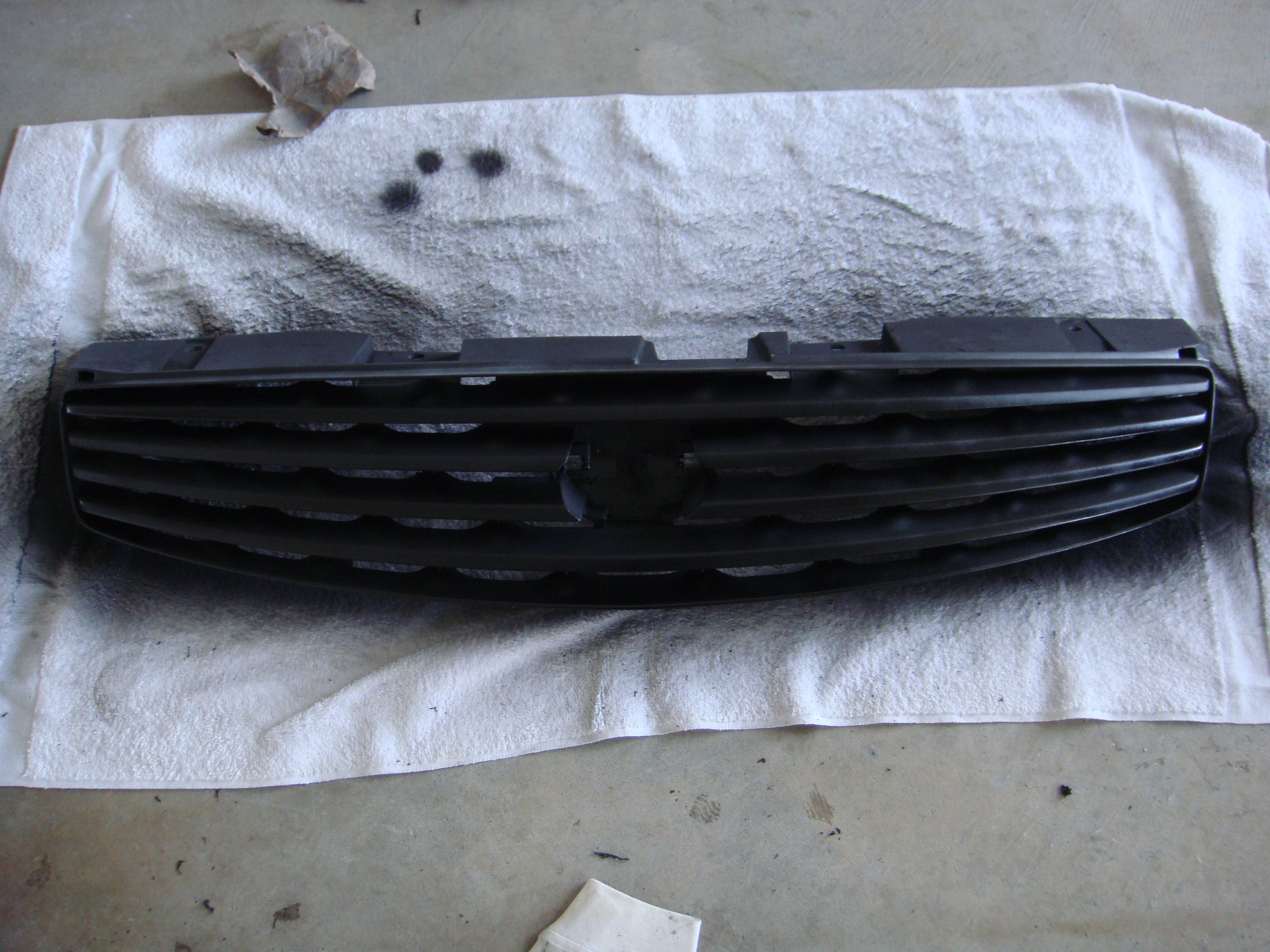

Primer (4 layers)
DIY blacked-out grille w/ pics-8daot.jpg
Paint (bout 6-7 layers)
DIY blacked-out grille w/ pics-h6jvb.jpg

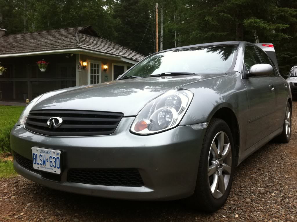

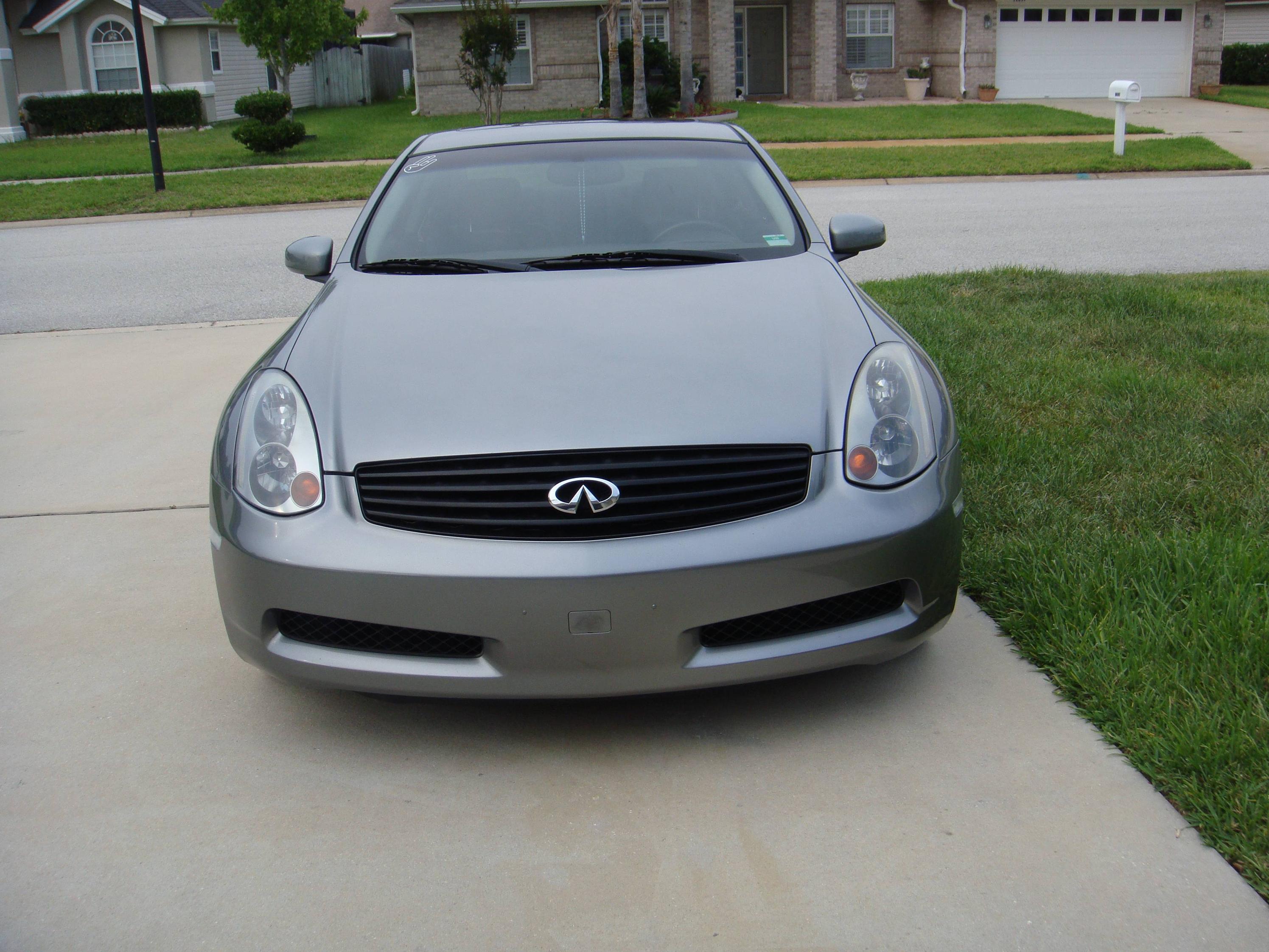

Did I get the rite materials?
I went with a semi glossy black because I thought the glossy black would be a little much by the looks of the cap anyways.
Also heres a pic of my car now has clear corners. Anyone have any pics of my same color sedan with glossy black grille?

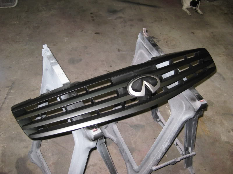

From: Canada

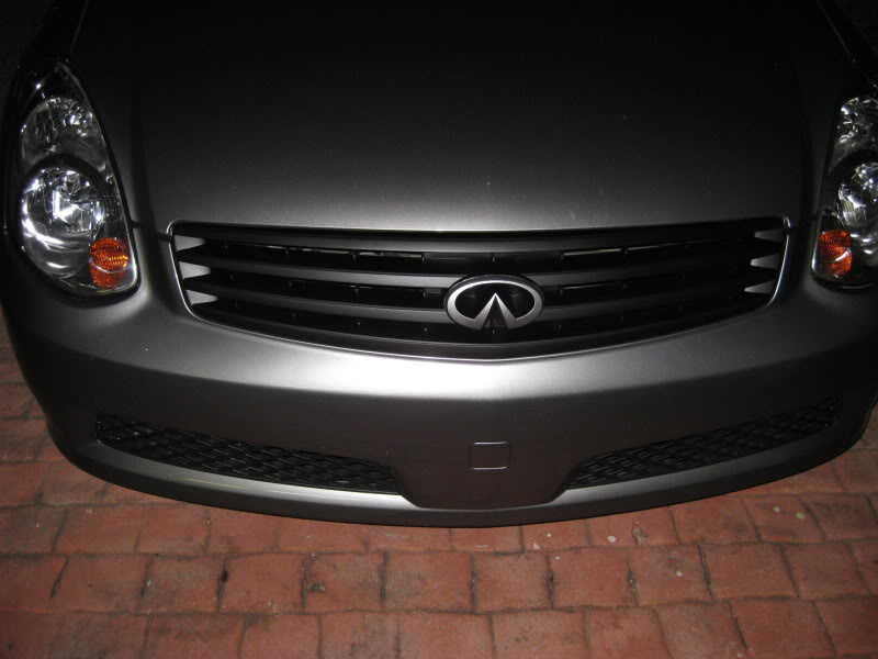

I flat blacked my grille last night. Sanded/primed/sprayed. Bought the wrong clearcoat so went without, I like the stealthier look for now anyways. I'll prob redo it in a few months with a clear or whenever it needs it or try and find a nice replacement.
Heres a Pic!
