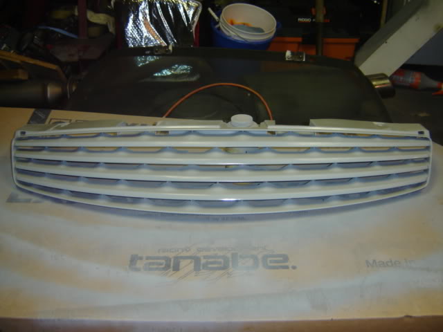

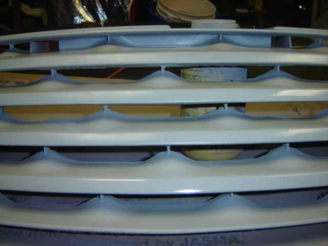

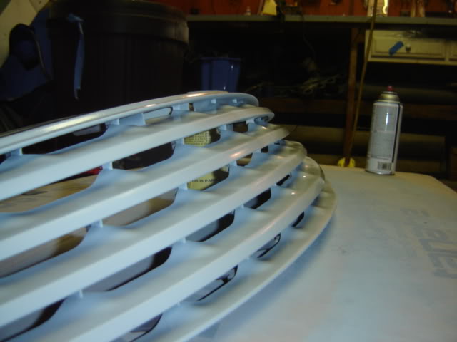

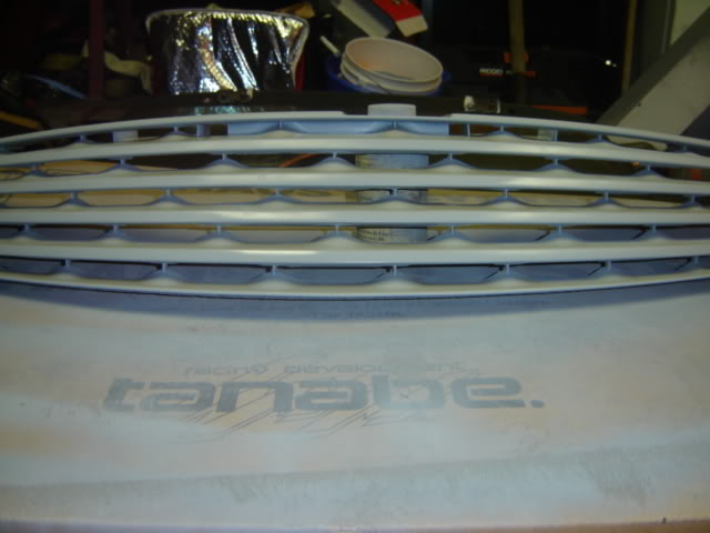

GreenGoblins...

wow looks perfect.. i just shaped some bumps.. so it doesn't look that great but it's good enough :P now I'm letting the putty dry and then primer and paint
