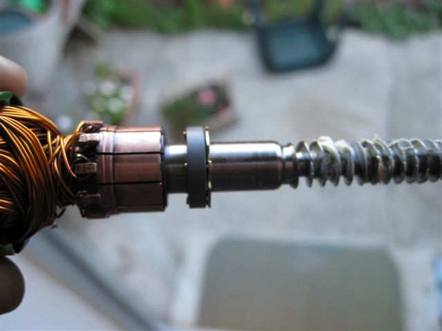

I took mine motor out, used MAF cleaner on the copper wiring, 1000 grid sand paper around the copper plating, use a needle to clean between, and WD 40 into all the holes in the motor assembly. q-tip the residue. white lithium grease around the thread, motor contact.
if you need to reset the window because it wont roll all the way up, with the door open hold the down switch for 5 secs after its down, and close the door hold up switch for 5 secs after its all the way up.
some pics... found 3 window flyer in the bottom the door
Attached Thumbnails Diy: Sticky For Window Motor Repairs/door Panel Removal-img_0396.jpg   Diy: Sticky For Window Motor Repairs/door Panel Removal-img_0402.jpg   Diy: Sticky For Window Motor Repairs/door Panel Removal-img_0404.jpg

wow man you had alot of Carbon Build up...funny thing is that my passenger decided to crap out on my yesterday...so I will be working on my window motors today.
