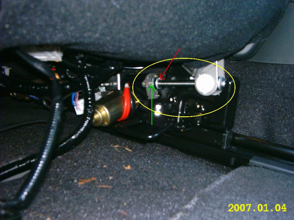

I did my best taking some pictures and editing them for clarity. Here you go, hope this helps. They are big "jpgs" I didn't bother to resize them.
Pic1
1)raise seat fully
2)move seat to front
3)rotate counterclockwise (optional)
Pic2
!)Red arrow is washer, don't squish this
!)Green arrow is 'NUT', not really a nut though and a pain in the @$$ to turn
4)Rotate this nut so it moved all the way toward the front of the seat.
Pic3
!)Same as pic 2 really, although a little clearer.
5)After you get the 'NUT' to move all the way front slide the washer (Green Arrow) all the way front, it should slide with some effort.
I got about a 1/4 inch from doing this. I was expecting more
EDIT 4/21/09: I attached the pictures so you won't need to scroll down so far.

6'3" here... Gome me about 3/4"-1" extra room now! Worked like a charm, exactly what I needed! Thank you!
