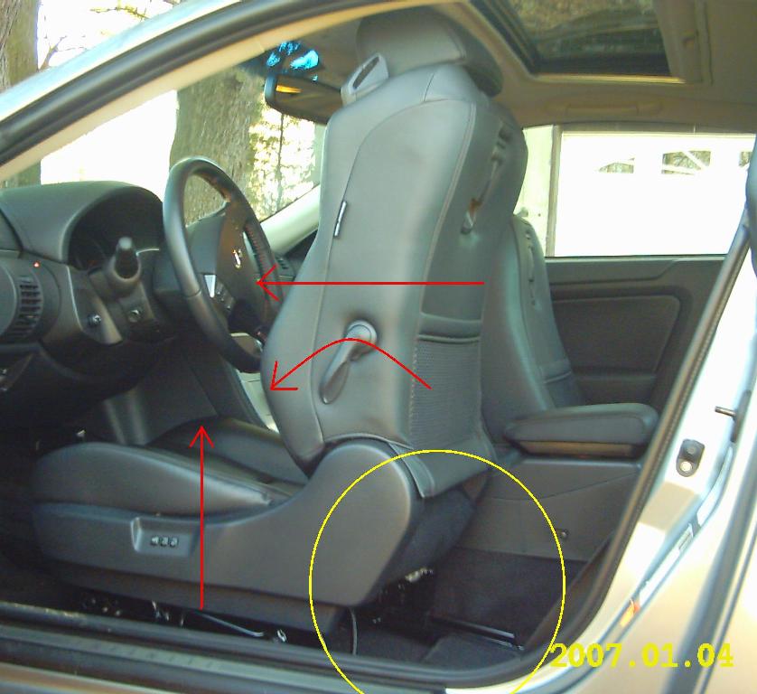

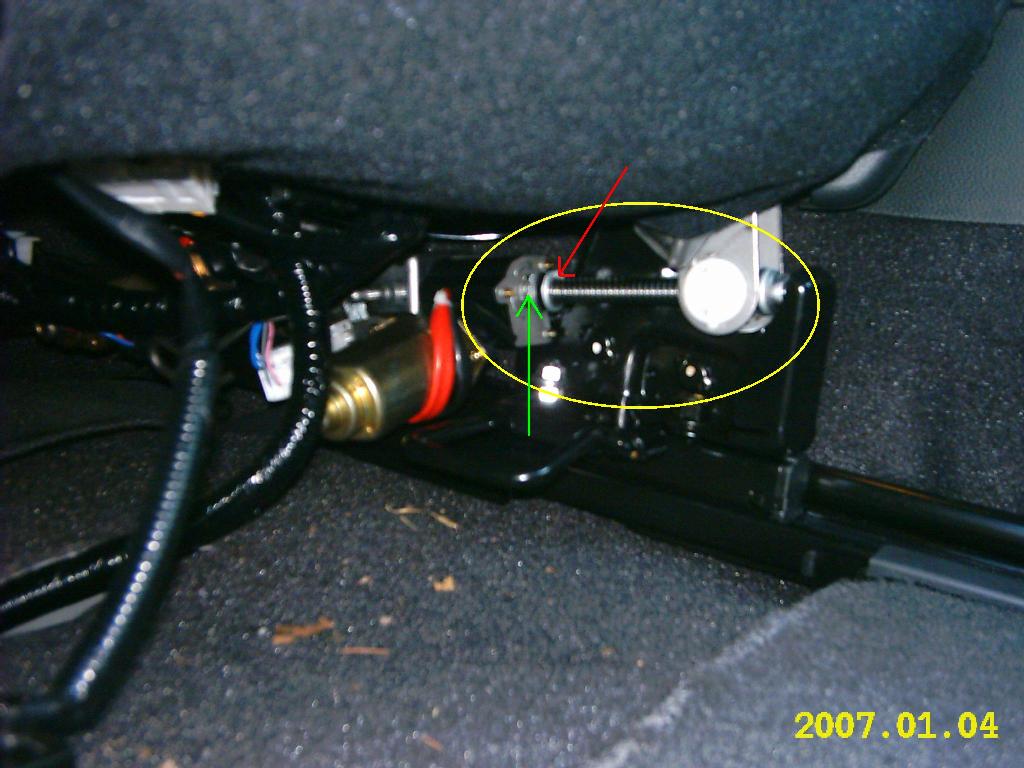

Originally Posted by johnnytremain
Anyone have pictures of how to do this fix? The original pictures and those on page 3 are not loading anymore.
Attached

Just tried doing this and it worked, but I messed with it a bit more and now I don't know where it's supposed to be. I can move the nut all the way to the front or towards the back, maybe halfway or near halfway. Where should the proper positioning of the nut be? And when it's set and I put bring the 2nd nut with the rubber stopper to it, is there any tightening needed or does it simply just need to meet with the front nut? And just to verify, this should be done with the seat all the way forward, tilted forward and the rear of the seat raised up correct?
Old Sep 7, 2008 | 08:32 PM
  #88
GWord256's Avatar
Joined: Dec 2006
Posts: 1,010
From: Cleburne, TX
I believe the original position was about 1/2" from the front of the screw
The rubber stopper should be pushed so it touches the nut, I don't remember any tightening
I found it easiest to work on the underside of the seat with it front and tilted forward, It won't effect adjustments just makes it easier to work on.
