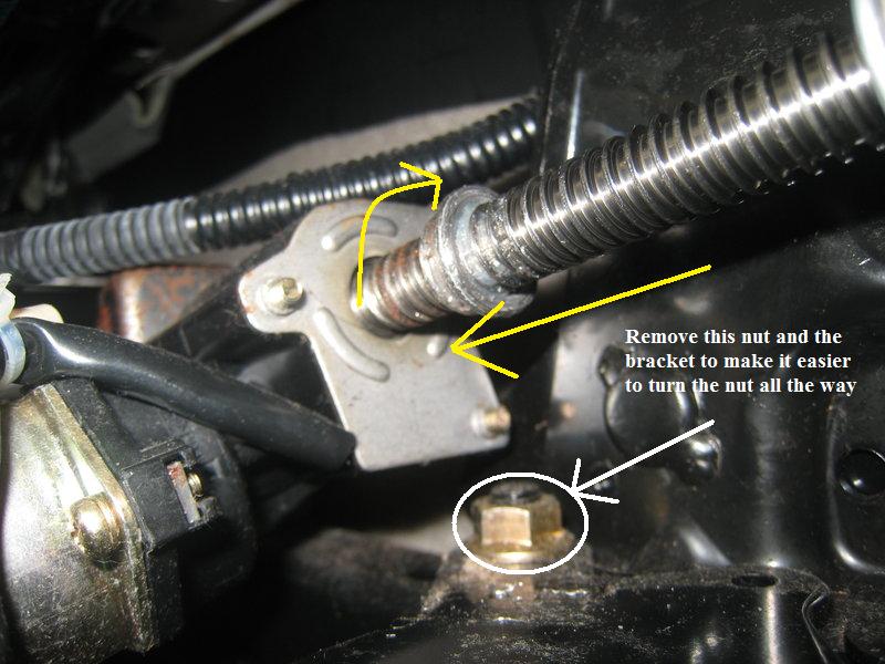

I just did this. I think they're referring to the rubber thing, the part towards the back end of the car. It should be pushed up flush to the nut.
Also, it was much easier to maneuver by removing the 12mm nut holding some sort of bracket with a U-loop in it down. Then you could turn the nut much farther. I just put it back on afterwards. I think someone else in this thread mentioned doing that.

Sweet Mod, I removed the bracket clarkkent06 mentioned above and it made it easier to turn the nut and I moved it all the way. I also laid accross the backseat like threeputzz mentioned . I got about an extra inch headroom. I took the car for a drive took some corners pretty fast and so far no problem with seat. Hope this pic helps
Lack of drivers seat headroom?  Easy, easy alt=
