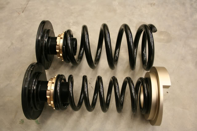

alright guys i am hear to bring this thread back up to its original topic!!
today i finally made it over to bc in orlando from tampa, since i am the closest person to them that has had this problem, and i spent all afternoon from 4 to 9pm with pete at bc racing trying to get this figured out, why it was happening, and how we could solve it!!
i had the new rear spring setup for a few weeks and what gettin the knocking sound when i would hit a small bump in the road at a low speed. my knocking sound, sounds like it is coming from up high not at the spring!!
pete and i drove around so he could hear the nosie. we get back to the shop and take it all apart and check several things, one of them being the preload. since i had sufficent amount of preload we determined that was not the case.
so then we switched my rears to the old setup and went from the 10k spring to a 12k spring. we put those in and put it all back together, and went on another drive. knockings sound was still there, still sounding like it was up high and not down low.
get back to the shop, take it apart again and try to decide what to do next. we decided that the spring loaded adjusters sound like the could be making the noise. maybe from hitting the body of the car. so we take the adjusters off completely and go drive around again.
noise is still there, so we get back to the shop and take it all apart again. next we decide to look at the pillowball maybe that is moving too much and knocking on the allen heads on the inside, but we can not find any marks anywhere!! so since we have the upper plate off of the shock now, we think that hey maybe its moving around and bumping into the bolts. so we test fit it up and see that there is a lot of play in it, as the holes in the plate are larger than the bolts. so we found something that would fit snuggly around the bolt and inside the hole. luckily we found some thing and mounted the plate back up there, and it fit like a charm. didnt move at all, so we put everything back together and went for another drive. noise still occurs!!
once again back at the shop, we take it all apart. we decide that maybe since there is a small gap between the upper plate and the body that maybe its hitting there when going over a low speed bump and causing the noise. by this time it is now 9pm, so we decide to call it quits. pete is goin to look into getting some thin rubber like gaskets (like those that go on the upper spring mount between it and the car body) made to go between the upper plate and the car body, to see if this will solve the problem. hopefully it will!!
maybe you guys that are having the problem can look to see if you have a very thin gap between the plate and the body.

in this picture you can see the little rubber pad at the top of the preload adjuster for the rear springs. this is what we are thinking might need to be added to the upper plate on the shocks. hopefully it will work!!
