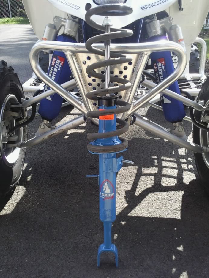

So a quick review of Tokico HP series shocks/struts vs OEM shocks/struts on a 05 G35 Coupe with sport suspension.
First let's look at the difference in size.
Front Strut: On the left is Tokico front struts with OEM springs. And on the right is an OEM strut with OEM spring.
As you can see OEM strut rod is a bit longer than the one on Tokico strut
Size:  135.9 KB Name:  front.jpg
Now side by side
Strut housing is same length on both but Tokico strut is a bit larger in diameter. Maybe it's just thicker walls or the diameter of the housing inside is actually bigger......I don't know.

My G is lowered on 350Z H-Tech springs so they are naturally shorter than stock springs. (don't have any pix to compare)
Tokico front strut with H-tech spring looks about the same as OEM strut with OEM spring (length wise)
Ride quality/difference:
I cant really compare cuz my stock shocks/struts were shot and felt like I was riding on rails, but from what I remember I say that ride will be a bit stiffer over OEM shocks/struts combined with aftermarket springs (350Z H-Tech in my case).
With OEM struts my H-tech springs were not compressed at all by the top plate of the strut, because strut rod was quite long. Now with Tokico strut it gets compressed just a little due to the shorter rod (as you can see) so I think due to that ride quality is a bit stiffer because H-Tech springs are progressive springs, so with that little of compression done by a strut you take away it's softest quality.

another thing that puzzles me about front struts is this.
Since rod is shorter than a spring and spring end up constantly pulling on the rod
Wouldn't that cause some kind of damage to the shock?

didnt even notice that, that does sound bad though, dont think it should be set up like that, im no pro so dont know how far my word goes.
