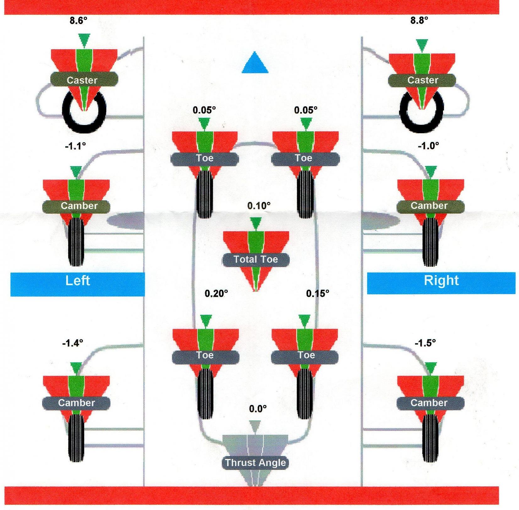

Thanx. Would you happen to know what my problem might be then. This is the second alignment that i have gotten with tires that have about 10k miles on them and they cant seem to correct anything from it. A while back, i was also told from a midas shop when I went to get an oil change, was that one of my rear shocks was leaking a bit. I still have not replaced that. here's a print out they gave me.

Springs don't usually wear out, and worn struts/shocks don't change your alignment. Post your after alignment specs.

Ok thanx. The attachment above are my after alignment specs that were giving to me at the alignment place.

The new specs look good. I'd get a second opinion on what might be causing the vibration at speed. I'd check wheel balance and suspension bushings/joints. If you can borrow someone else's wheels/tires for a test ride, that could tell you a lot.
