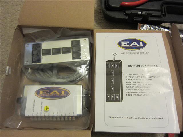

  #293
psycobusa's Avatar
Posts: 477
Likes: 18
From: Houston, TX
I have an unused 9 switch box if anyone's looking for one.
Old Feb 25, 2012 | 04:33 PM
  #294
kennymo's Avatar
Joined: Sep 2009
Posts: 3,205
Likes: 23
From: bay area
pics?

Old Feb 25, 2012 | 10:55 PM
  #297
psycobusa's Avatar
Posts: 477
Likes: 18
From: Houston, TX
Originally Posted by kennymo
pics?
