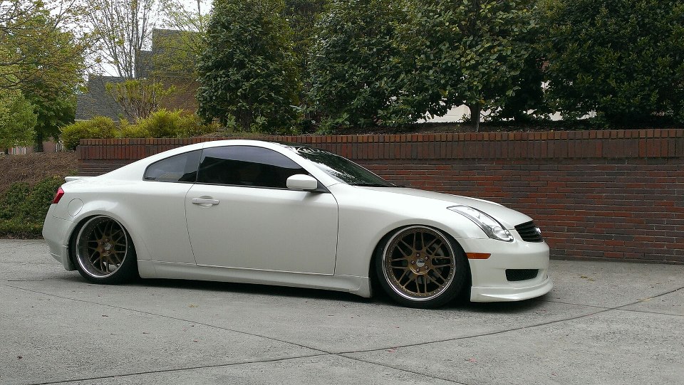

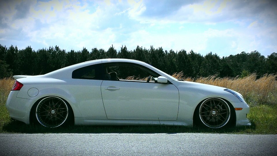

  #420
AccordinlySlo's Avatar
Posts: 296
From: Atlanta, GA
Here is mine, just got done last week. BC coils with bags/brackets from Bagriders.com. Running the Accuair ELevel mngt system with ILevel
