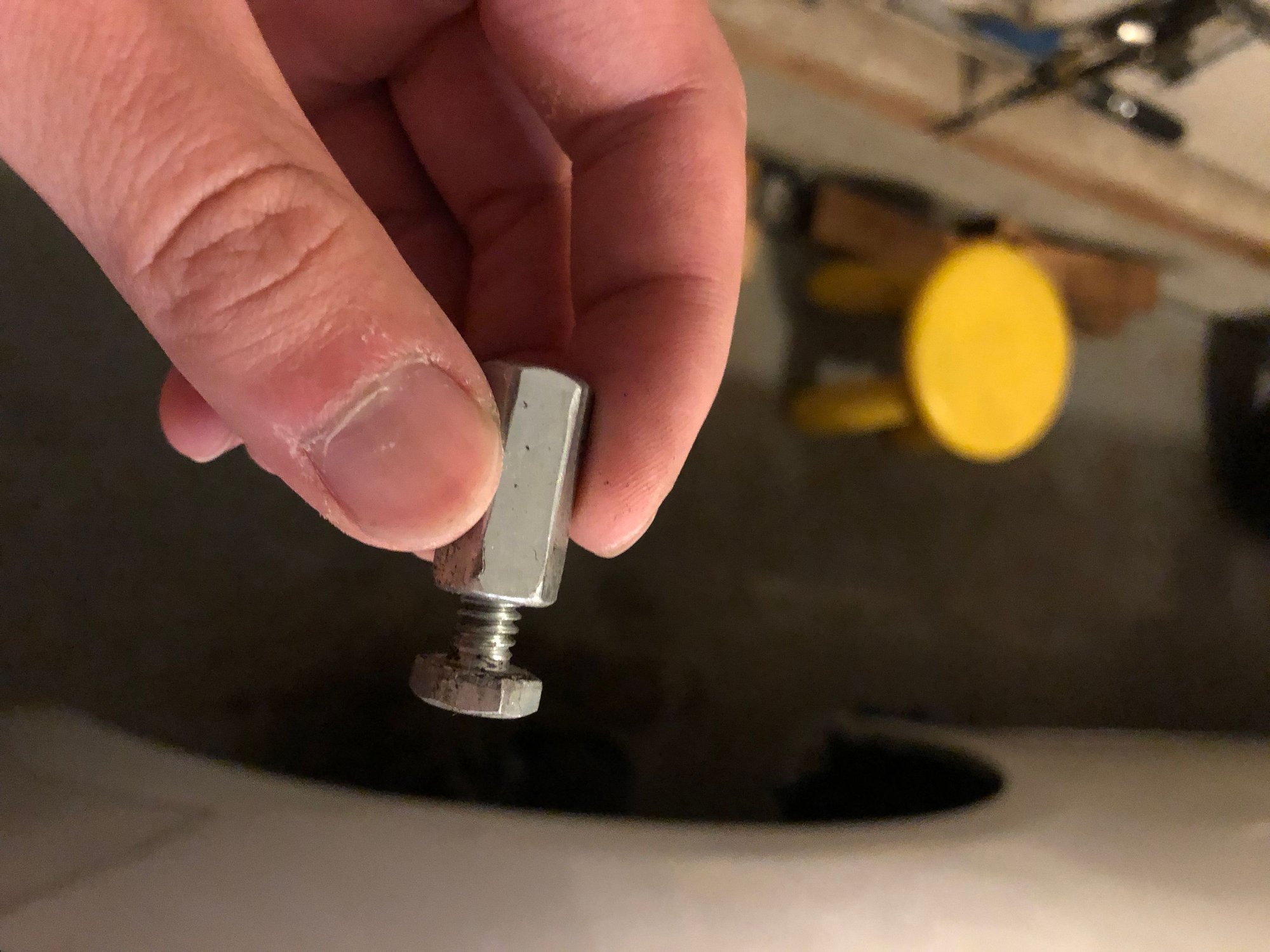

Go to Home depot and buy yourself 2 hanger nuts and 2 bolts like shown below: The hanger nut and bolt when completely screwed in will need to be smaller than the gap between your wheel bearing and the car. For V36 that distance is 3.5 cm.
Hanger Nut and Bolt. Buy a pair (2 hanger nuts and 2 bolts)

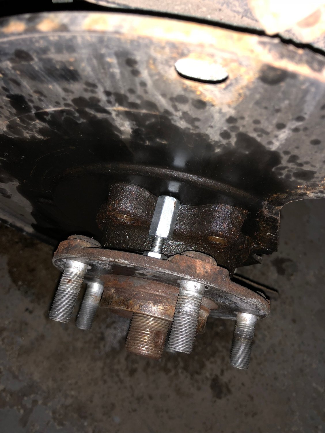

Place 1 pair of hanger nut and bolt above and 1 pair of hanger nut and bolt below the wheel bearing.
Place the hanger nut and bolt between the wheel bearing. 1 above and 1 below the wheel bearing so you can press out the bearing evenly.
Only thing to watch out for is to make sure the other side away from the bearing you have something solid to jack against! I have a V36 and that place happens to be between the 2 bolts holding the wheel bearing in (and 2 bolts below for the other set of hanger nut and bolt below the wheel bearing). Now that they are placed, use a pair of wrenches and turn the bolt counter clock wise (Loosen the bolt away from the hanger nut), this will put pressure on the wheel bearing and force it out. You want to press above and below evenly.
I didn't even need to turn it that hard. After being snug against the wheel bearing, I made 1 full turn above and below and immediately a thin crack between the wheel bearing assembly and the rest of my car formed. After 3 full turns my wheel bearing popped right off (Less than 1 minute). My dust shield was in perfect condition and the wheel bearing came out nice and easy and controlled. I honestly hope no one else ever uses a hammer to try to remove a wheel bearing assembly. This has been so easy and painless I am very surprised that it is not communicated more. I hope this helps and saves you guys the time and frustration I had to go through
