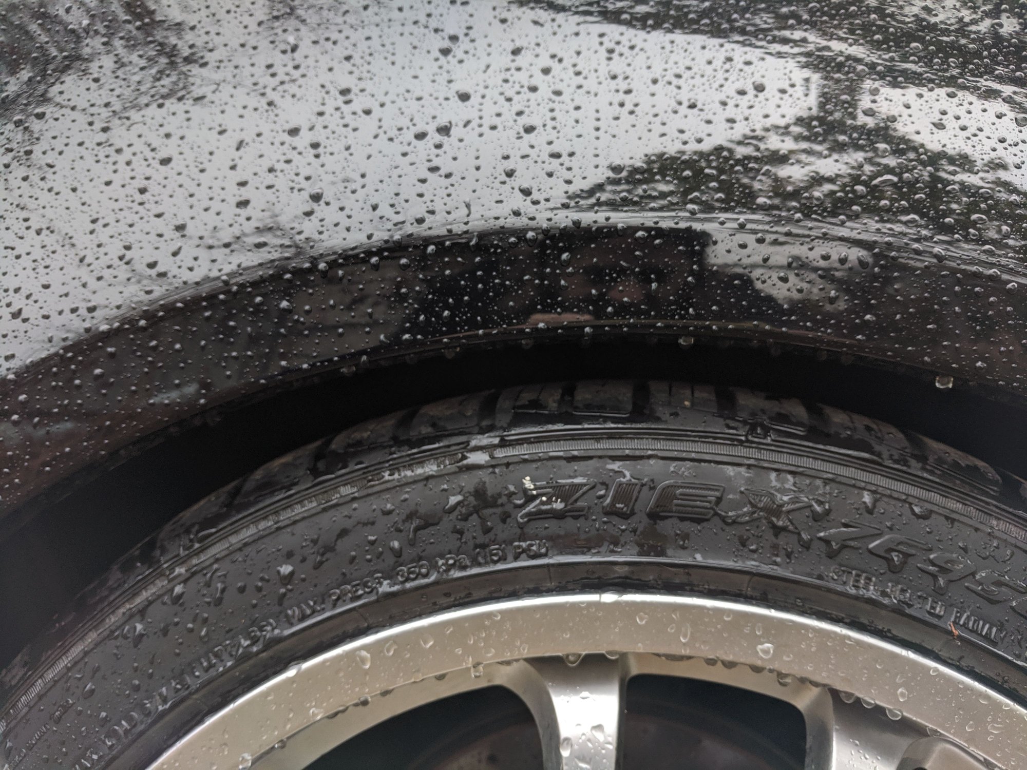

Here's a couple close up shots of how the 350Z revised springs look on the coupe, they have EXCELLENT ride quality for road use and are not too stiff or springy at all. I previously had the Nismo S-tune suspension which sat about 1" lower and it was incredibly stiff, I wouldn't go back to either that LOW or that STIFF but this car is just a fun weekend warrior now. Ignore the shitty tires on it I was doing a slalom in-town and it's been dumping rain all weekend (Washington yay!) and my Michelin cup tires are really shitty when it's that wet/cold and pushing the car hard.
I'm parked on a little dirt hump in the ground, the car isn't actually as low as it looks.
Front
Rear
