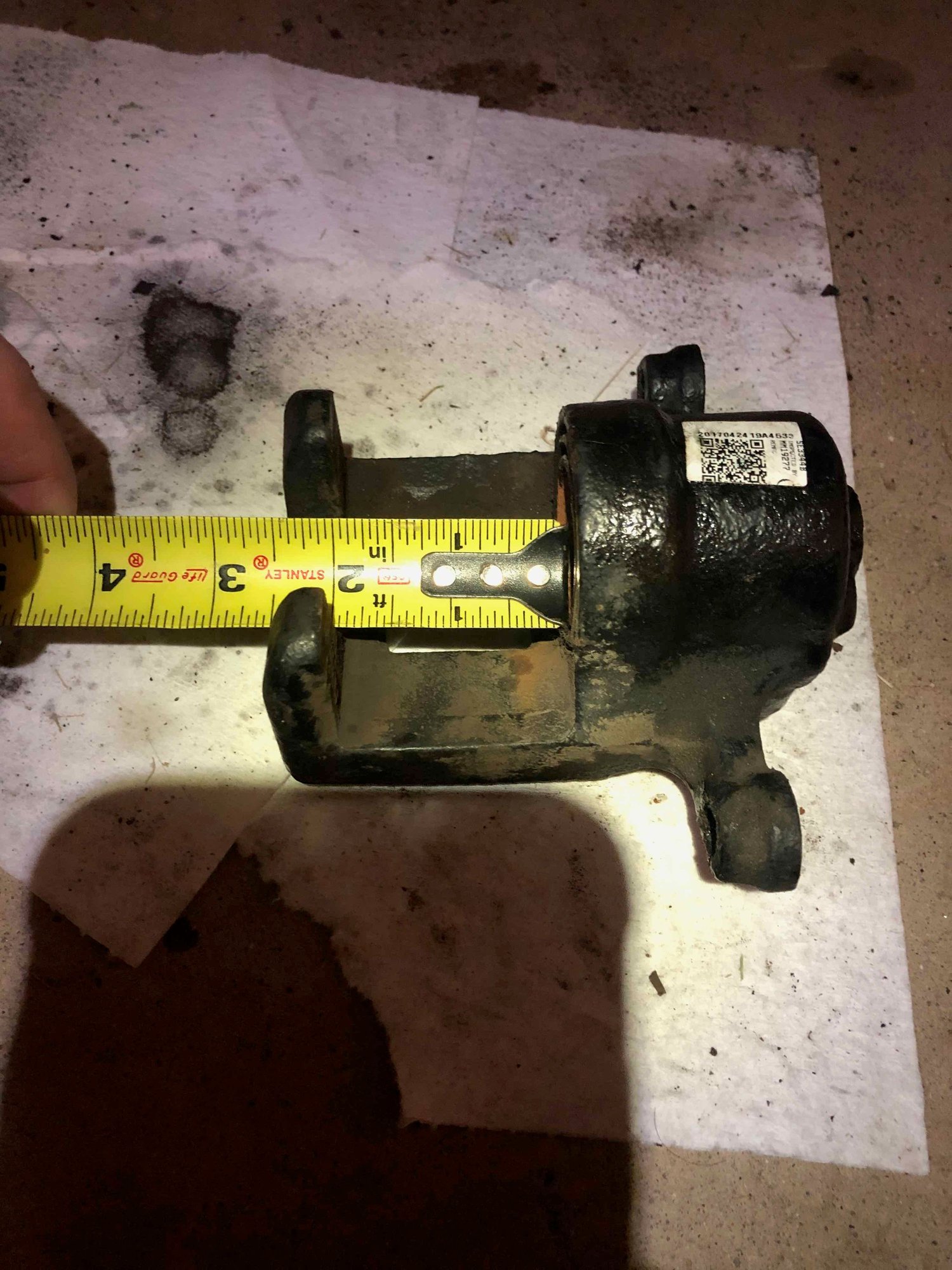

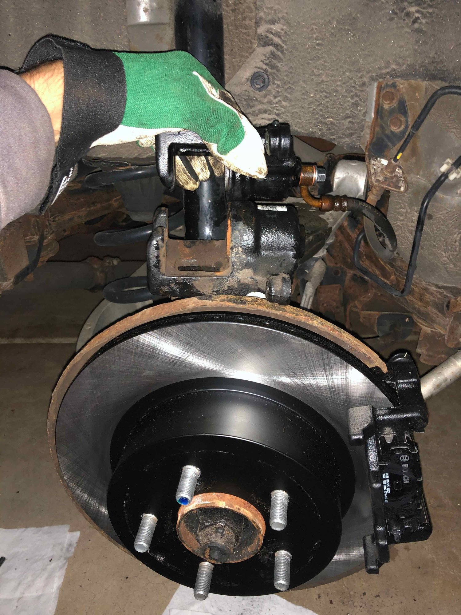

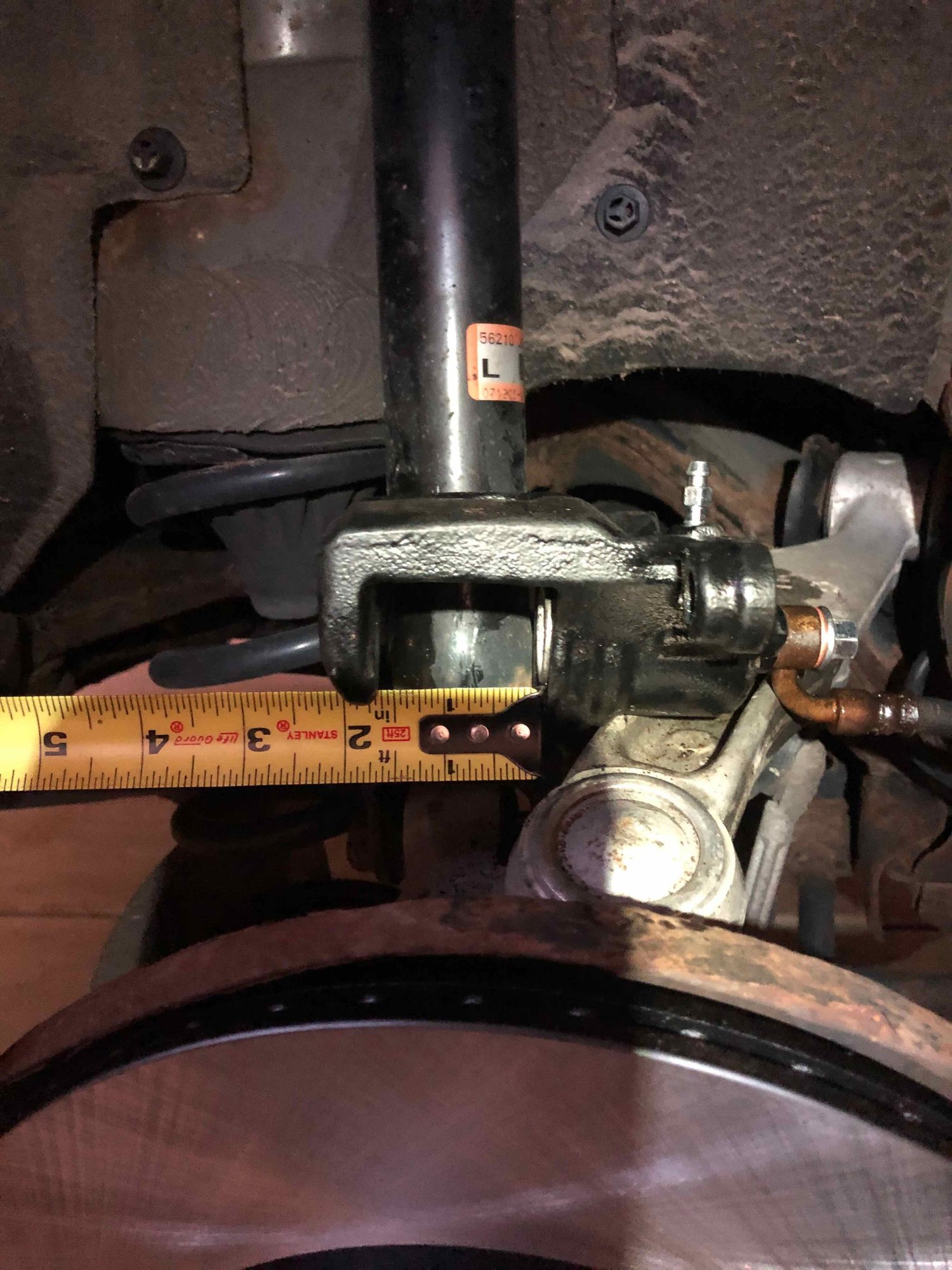

Got passenger bracket on, pads in, ready to close it...caliper will not go over pads. Upon further inspection, passenger caliper is almost 1/2 inch tighter than driver side and the OEM I'm replacing?? Did I (dealer) just get the wrong part or am I missing something? The originals were both the same size (and same size as the driver's new one).
Thanks for the input!
Original, 2" opening
New, a little over 1.5" space??
Comparing the two

Right rear caliper on an X model should be Nissan part number 44001-EG50C
I'm guessing they accidentally gave you part number 44001-JK00A
