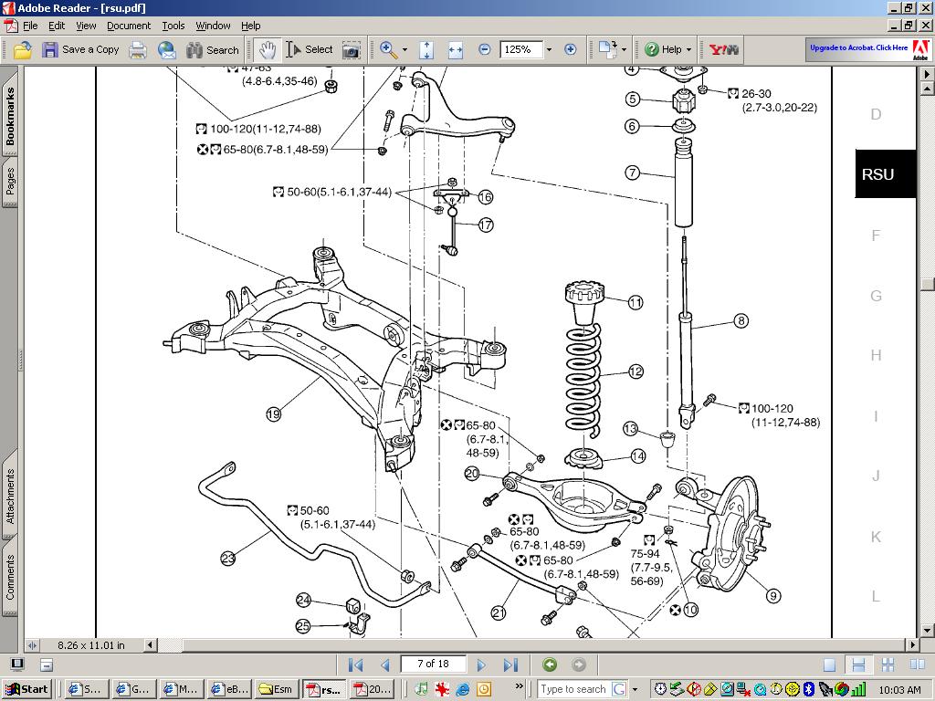

crap, that top nut is stubbon as hell to remove on the rear endlinks.
im going to go buy the black bracket that the endlink mounts to.
i couldn't loosen that damn nut.
Anyone know the part number for the black metal brackets that the
end links mount to? Its the kinda-triangular piece that bolts onto the
chassis and attaches the endlink.
thanks.
thanks.
Originally Posted by drsifu1
according to the 2003 g35 coupe list, the item is 54650-AL500 for both right and left
called a "Bracket, Stabilizer Bar" $11.10 ea

Just got back from the dealer, placed an order. they wanted $28.50
or something each though. lol. i don't care i ordered both.
I put my originals back on my car last night but forgot to note the
orientation.
-> Which way was the upsidedown bracket's "L" positioned at? Does
anyone know?
1. I *think* the verticle part of the upsidedown "L" was towards the
outside of the car.
2. The nut to hold the endlink was towards the inside of the car.
My plan is to use locktite RED and just assemble the bracket and my
spare endlinks off the car and just swap them out when it's time.
