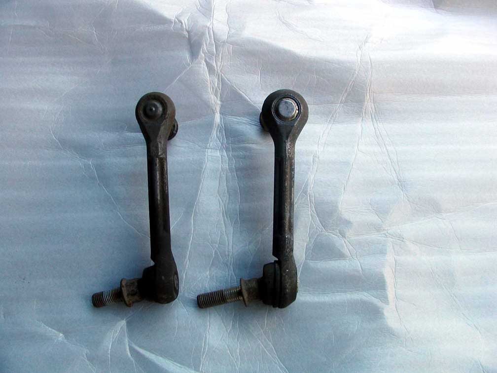

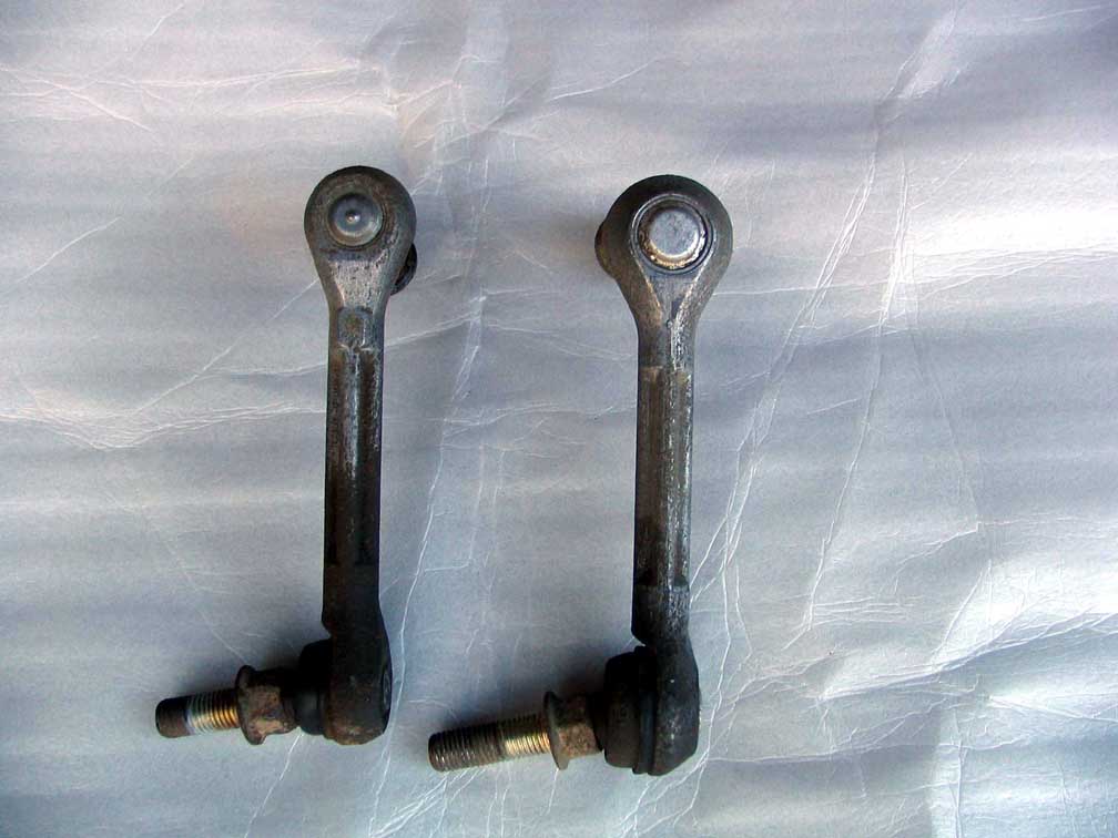

Here are 2 pics comparing the old OEM end-links with the '05+ 'up-grades'. The new ones are definitely 'beefier', more noticeable when you compare them side by side than even the pics show.
Hopefully they'll last longer than the old ones.

Gord, are the '05's longer and thread studs longer too or is that an optical illusion?

No, I think that's just a result of the angle of the shots.
