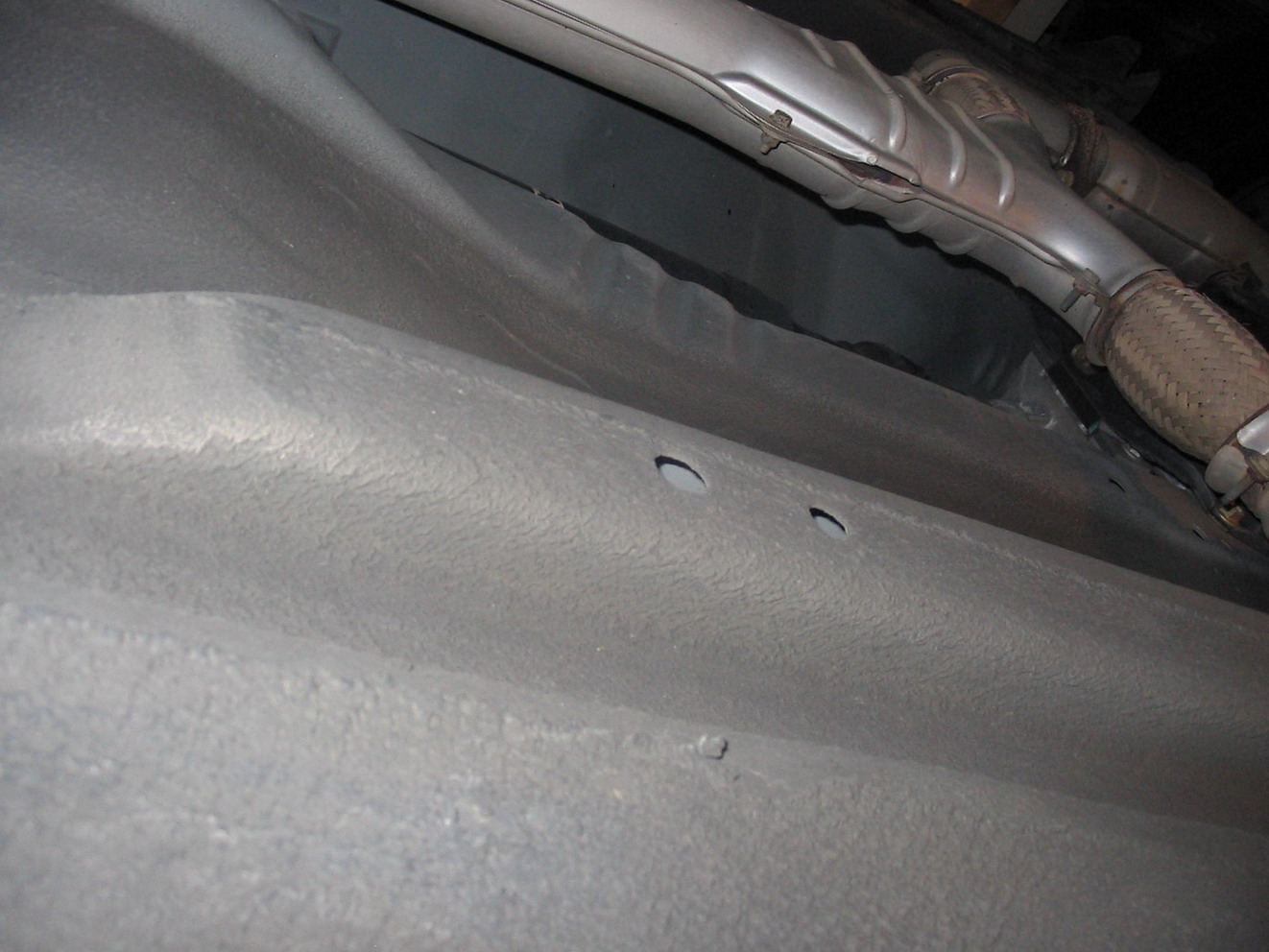

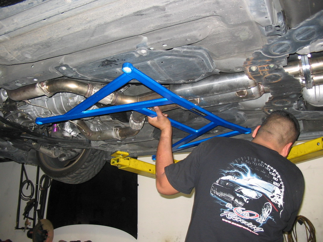

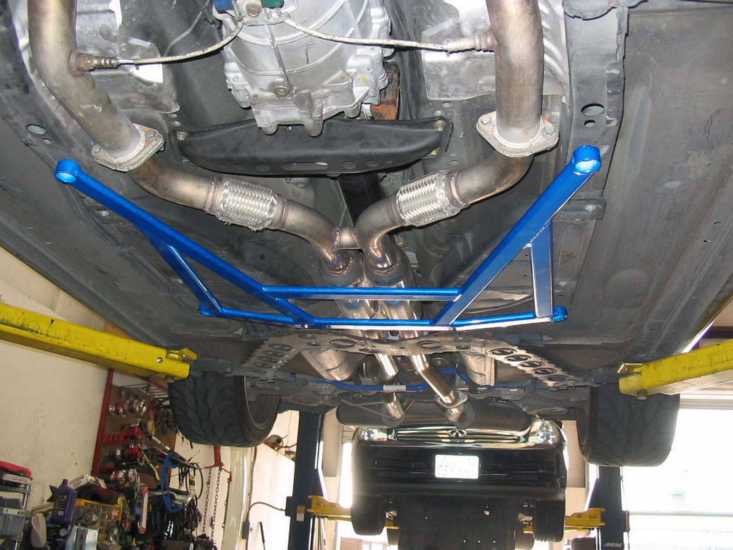

Ken at GTSPEC contacted me last Monday and said he was shipping the 4 point brace. I have yet to see it arrive. Today I changed my oil in the garage. I decided to check out my underbody and and compare it to the 350Z in the install pics. I do in fact believe the G35 sedan has a configuration very similar to the 350Z. It appears that the rear of the brace is atttached at a point behind the two easily seen holes in the frame. Those two holes are present on my sedan as are the three close to the Y-pipe. There must be another hole on the 350Z that doesn't appear on the photo. Anyway, I'm pretty encouraged. I might just need two holes drilled.
