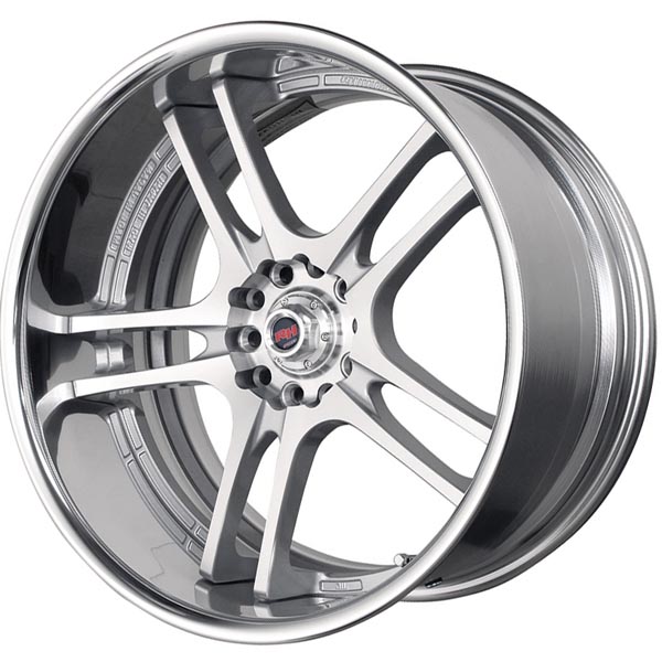

Old Jul 19, 2007 | 08:48 PM
  #270
jd2k1's Avatar
Joined: Jun 2005
Posts: 188
From: Rosemead, CA
Exclamation
I have Racing Hart J5 Pro with polished lips. Right now the lips are not as shiny as before. How do I go about repolishing the lips? Is there some chemical I should not be using to clean my wheel? I'm just using the same Zaino stuff I use to clean my car to clean the wheels.
Also what should I use to clean the area between the spokes and the lips? That area is probably less than 2mm and it's hard trying to fit anything in there. A good amount of brake dust is in that area and it's almost impossible to remove it.
