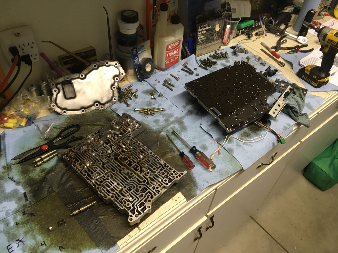

Tow it to a transmission shop. Moving it more than 5 feet is putting your whole trans at risk ...
TCM is inside the trans, yes. You must drop the valve body in order to access it. That means 8 qts must go back in after swapping it, if that is the problem.

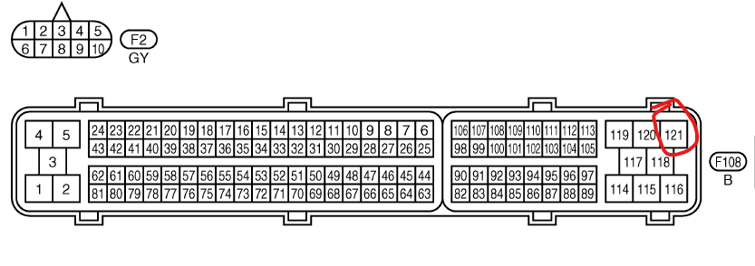

That code is for the ECM not the TCM. ECM backup power failure. Disconnect the battery, pump the brakes, disconnect the ECM, plug the battery back in and check for power on pin 121. If you have no power then you need to troubleshoot that circuit back up to the fusible link/IPDM in the engine bay. If you HAVE power on that then your ECM fried.
