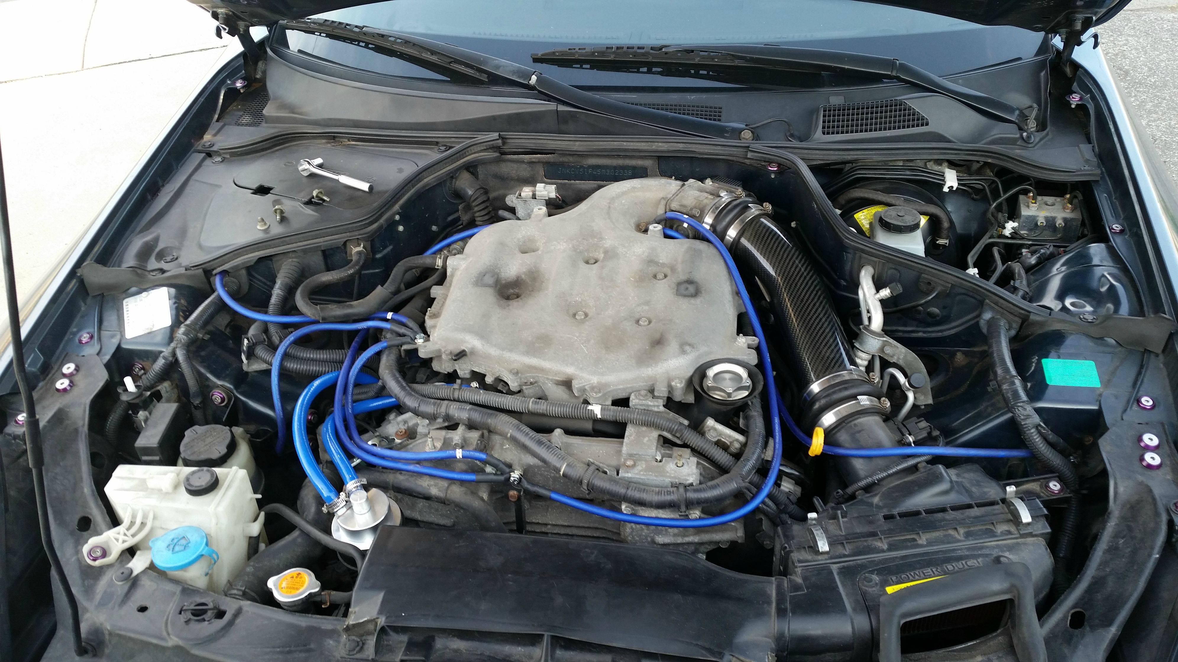

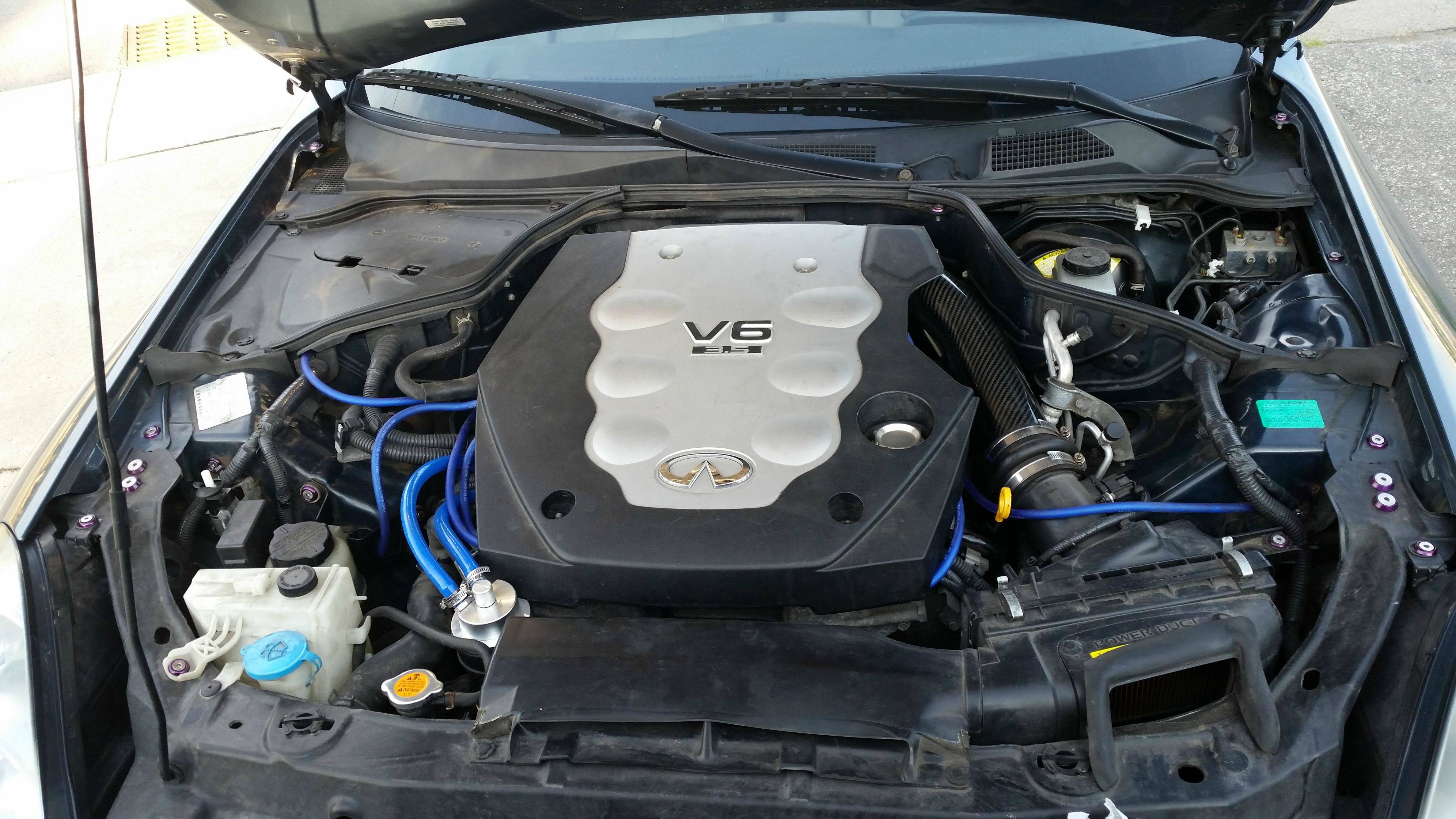

http://simotausa.com/carbonfiberoilcatchcan.aspx Bought this bad boy and it's worth every penny!

Pics installed?

Poll: Oil Consumption-dyjgdbu.jpg Poll: Oil Consumption-r2lqqpa.jpg
