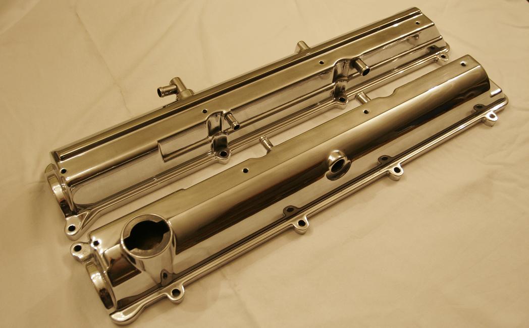

maybe someone can volunteer to make some polished aluminum or stainless steel valve covers with replaceable o-rings?
Attachment 92771
Attached Thumbnails Check this before your powertrain warranty is up!-chrome-like-polishing-valve-cover-19.jpg
