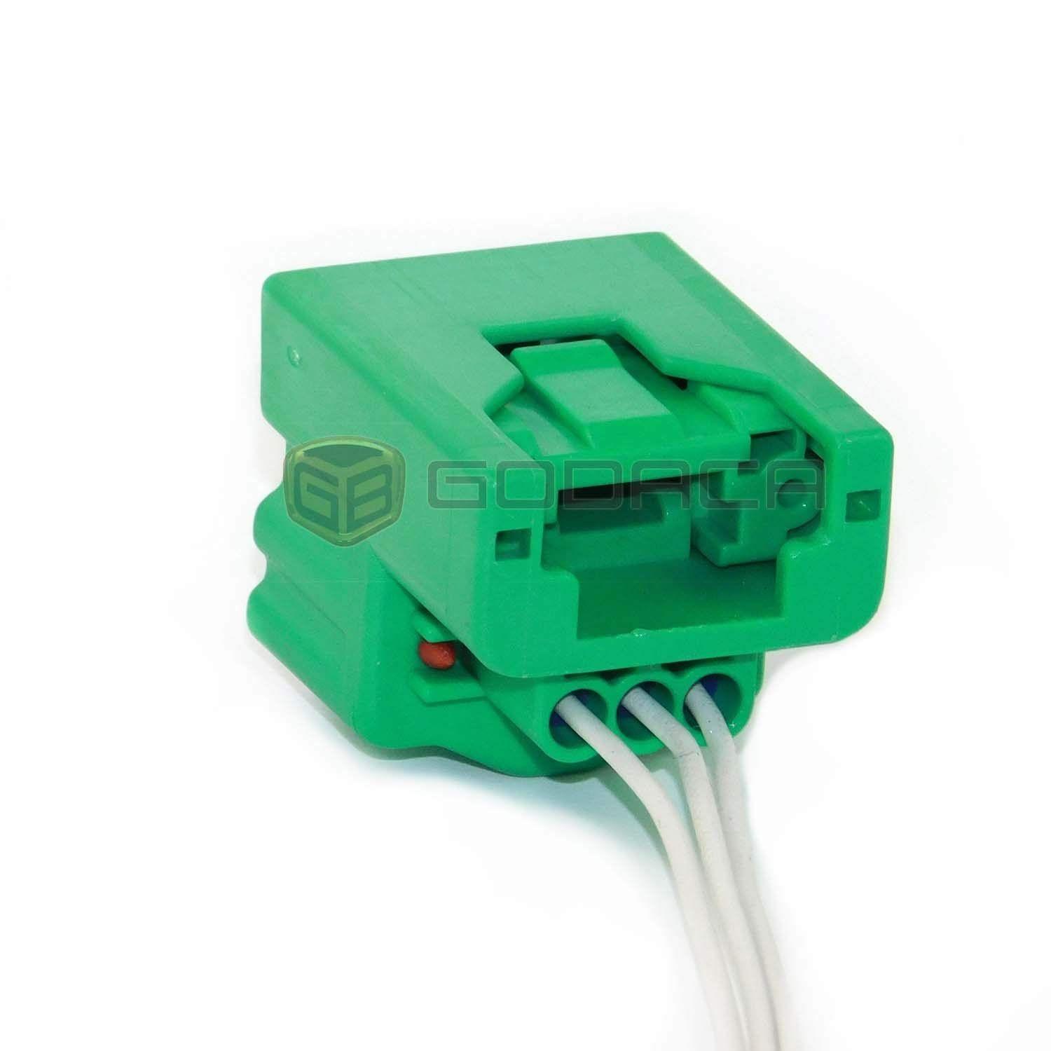

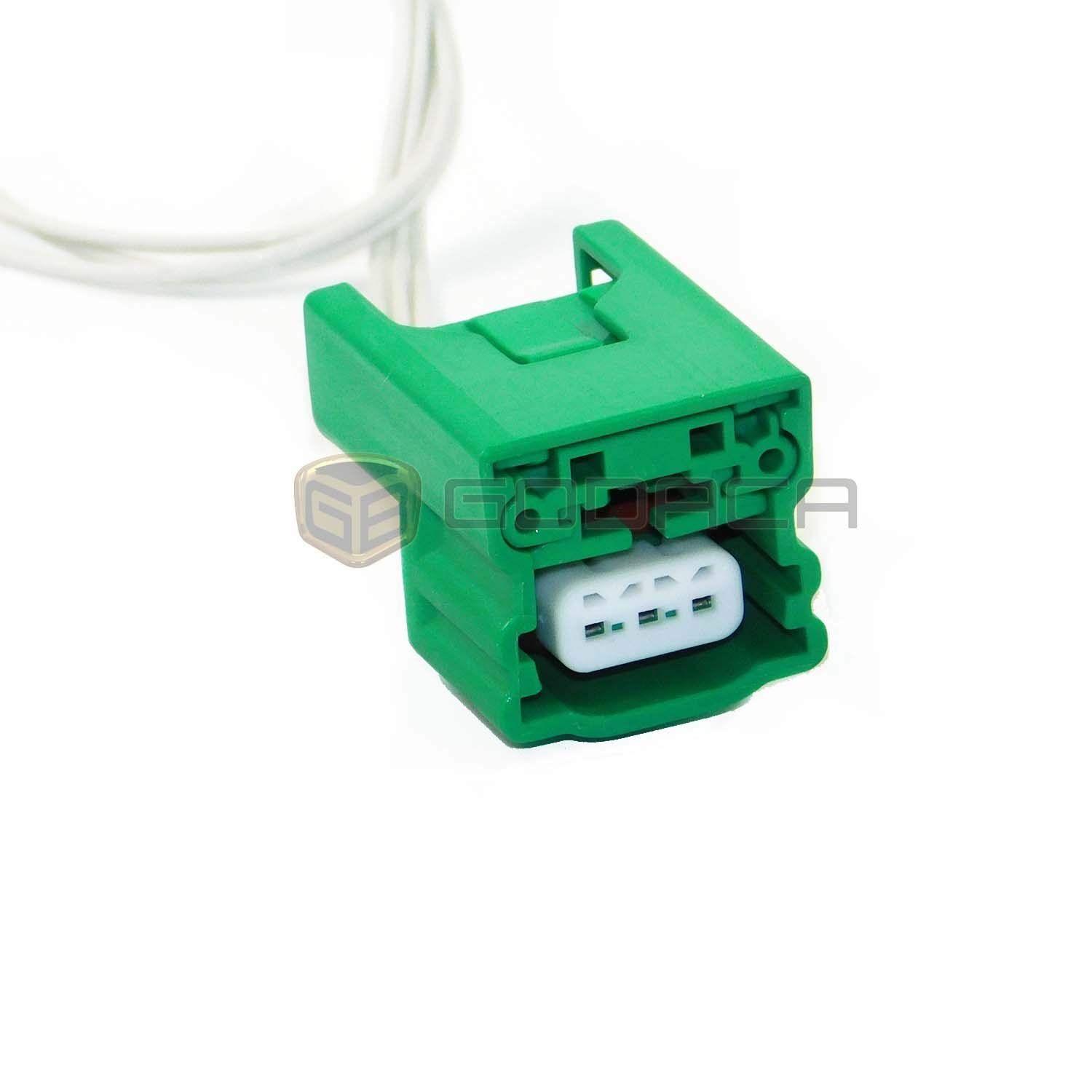

Corrected release harness method
So actually you do not squeeze the tab at all. The entire green tab needs to be pulled towards the sensor. The entire green section will slide forward locking into place. The sensor will them release.
Hello all to everyone who has been so helpful in this thread!! Also got the P0345 error and had a hard time starting the car.
After reading this whole thread, decided to attempt going in "blind" from the passenger side to the driver side sensor. Found the sensor and could confirm that the locking section (can't see but supposed to be green) slides "back and forth" towards the sensor. By pushing down hard, I could get it lock in place - that SHOULD mean the tab is released (right?) But I have a hard time pulling the connector off the old sensor.
I know it varies from car to car and also from one hand to another (I do not have a vise grip pinch!) But if anyone has done it, please comment on how hard the connector needs to be pushed/rocked/wiggled in order to shake it loose from the sensor. I tried pushing from the bottom, rocking it left and right and wiggling it up but it just would not bulge. Any trick, tip or advice would be much appreciated!! Thanks!

I'd be careful doing too much wiggling since these sensors have been exposed to a lot of heat in that firewall area and the plastic is likely pretty brittle. If you were to break something, you'd have to pull a lot of parts out to have enough access to fix it. I did mine recently on an 03, and once I got them unclipped they came out very easy.
The pictures I attached below are pulled from various other threads regarding this. They may have illustrate better what everyone means by pushing the connector tab towards the sensor rather than pushing down like you would on any other connector.
Thank you, John! Yes, the pics and other comments on this thread explain the rather un-usual way the "clip" works in this connector. I also found close-up pics of the connector itself which shows the tab and how it will release when push "down" (see attached.) My problem is that when pushing down, the clip would stay in the down position (rather than bouncing back up) which I thought meant it was released. But the connector remained tight. I saw other comments, like yours, that when released, the connector should come off easily. So I guess I did not push down enough
Funny thing is I could hear a click when I pulled the sliding clip up! I was afraid of breaking anything too as I could there was little give in the cables attached. Will have to try pushing the sliding clip down harder...
Thanks again!
I understand what you're saying now about the pushing down. That's funny, usually a click does mean it's unlocked and ready to pull. Good luck!
