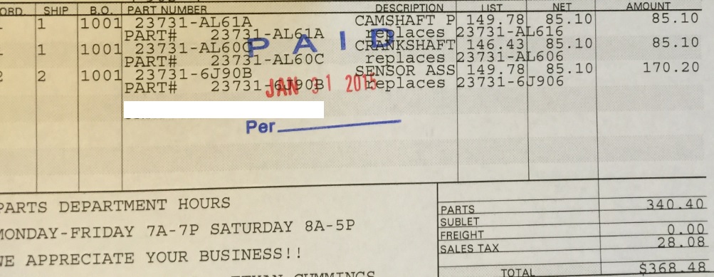

Originally Posted by vq35dedriver
BTW I didn't use oem sensor cause them biches were 200+ a pop after tax. I used a sensor from a vendor cause a homie got the hook up. Good luck to everyone doing this, hopefully it's as easy to you as it was to me.
Exaggerate much, more like $85 a pop

Nissan sensors are a bit over 100 here in Canada.

Nah no exaggeration, I called 2 nissan dealerships and 2 infiniti dealerships. Got +/- 5 dollars from 175-195.
I was gonna use OC infiniti for the sensor it was 86 plus shipping but I needed the sensor right away. G is my DD.
