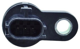

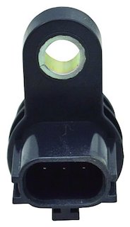

Thanks for the great DIY. Saved me a few hundred bucks and time. Dealer wanted $350! My mechanic wanted $162. I only attempted to replace the passenger side sensor. Driver side might be a mechanic job! I don't really have the facilities to work on my car like that since I live in a condo.
A few tips, definitely get a 10mm gearwrench, it's worth the $15. I got the angled one so it was even easier to get at the bolt. When it's time to work on our car, tie some string to one end of the wrench. You WILL drop it and with the string you can just pull it back up again. My G has that silver metal tube in the way of using a socket wrench BTW.
After speaking with my mechanic, he told me the OEM part was Hitachi so that is what I bought for $50 on Amazon. Dealer wanted $163 and mechanic wanted $112 so there is some great savings right there. When you buy it make sure you buy part CPS0004 with the plug perpendicular to the bolt. I bought CPS0002 which is exactly the same part only the plug is in line with bolt making it nearly impossible to get the wrench on the bolt.
DIY Cam Position Sensor Easy Version-cps0002.jpg Hitachi CPS0002
DIY Cam Position Sensor Easy Version-cps0004.jpg Hitachi CPS0004
I absolutely left the clip on when I removed the sensor. Just undid the bolt and pulled it out. There was no way I could get my hands in a position where I could remove that clip before taking the sensor out. I had to use a flat head screwdriver to push the tab down and there was no way I could have done that while it was still installed.
I put the clip on the new sensor before putting it back in but that may have been a mistake. Because of the plug configuration it was hard to get the wrench on the bolt. This may or may not be an issue if you buy the correct sensor. In any case, I think had I left the clip off, I may have been able to use the wrench more effectively. I was only worried that I wouldn't be able to push the clip on fully after it was installed.
One of the best tips on here was to use needle nose pliers to put the bolt back in place once the new sensor is put in. There was no way that I was going to be able to maneuver my hand to get the bolt into position without using needle nose pliers to put it in place. I dropped the bolt once before remembering to use the pliers.
