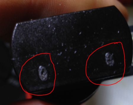

I'm having some issues with my 2005 G35X where it stalls at a red light when in gear, idles to about 500RPM (cold/warm), takes 5-10+ cranks to start when warm... Based on this thread it appears to be the Camshaft Sensor/s.
I took out the sensor's and I see markings on the sensors (like indicated in the diagram), can someone tell me if this means my Camshaft Sensor/s are shot/Chipped?

Thanks for repsonding Jeffrey... In photo 4 it mentions to visually check the sensor for chipping, which is why I was asking. Not sure if it's anything, but it nearly looks to be so based on the image I provided. I'm thinking this may be a sign the sensing magnet/s are damaged and therefor reporting incorrectly causing the issues I'm having. Make sense?
Thanks, is there any where else to purchase the CAM Sensor besides the actual dealership?
Thanks again.

Totally didnt even see that lmao!, i still have mine imma go check haha, well ur problem sounds just like mine and ur lights stay on too like the VdC and check engine and other stuff too, well u can buy them any where but its the part where it's more likely to break or not work right after a couple of months compared to the dealer uk

To be sure that is why u check the ses code. It's will tell u exactly. I first bought mine from orielys out of convenience but it didn't work well. Went OEM right after. Bought online was almost the same price as orielys anyway. They go for less then $100 at online OEM dealers

Checked the code, says it's the Crankshaft Sensor, went to AutoZone and picked up the part for $39 (Duralast w/lifetime warranty). Works like a charm and so far no issues with multiple test runs.
Was pretty easy to switch out as it's under the car so no fiddling around the motor.
