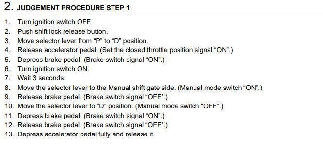

Here are the steps for the self-diagnosis
thanks so much for that! I'll try that out

The instructions changed over the years. The steps for '08 models is similar but not the same. It uses a 22-second sequence too vs 17-seconds.
