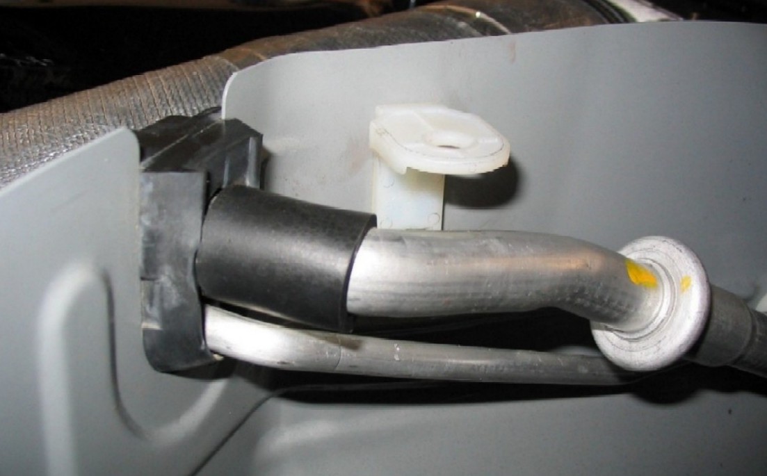

has anyone else ordered the jdm battery cover for the driver side of the g35 coupe..... cuz for some reason i cant get a snuge fit on it, only thing it came with was the 5 plastic lock nuts and a white bracket, now where would the white bracket be placed
if anyone can help it would be much appreciated thx

For the white bracket. Look at the battery cover on the left side, you'll see a corresponding white bracket. You'll need to drill at least one hole for it, but mount it in the same place on the right side

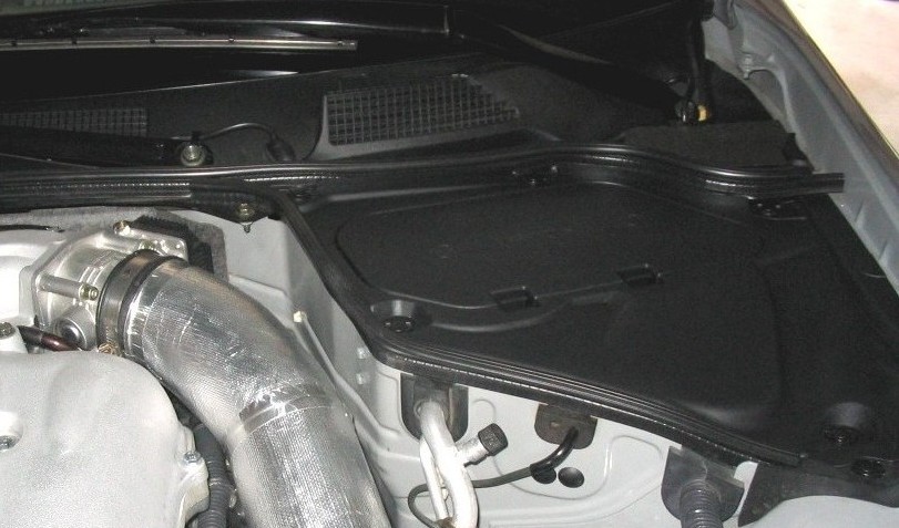

I've installed three JDM covers. All required significant modification to allow the cover to fit correctly--flat and properly supported.
Here's where I put the bracket on my initial installation. On the two other Gs I modified and placed this braket under the center rear hole for better support. I also added a second bracket at the rear center location on my car.

Old Sep 21, 2005 | 05:38 AM
Og_Dave's Avatar
Posts: 1,105
From: California
Originally Posted by DaveO
Here's where I put my bracket.
thx man, i needed a photo to help i appreciated alot
