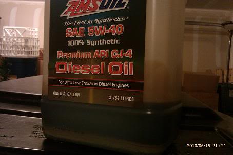

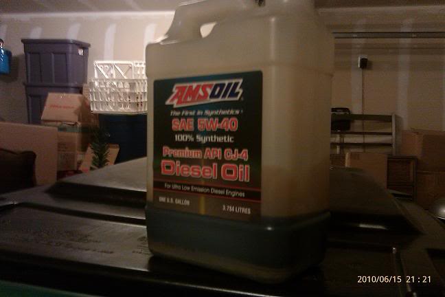

the oil catch can listed in the original post is excellent. i've had it for over a year and it's my favorite mod for sure (and i have alot of mods). i use a rubber stopper in the bottom hole after removing the "valve" that's on the bottom.
i started dumping all the oil from the can into a bottle about 10 months ago, so i could measure how much oil it's catching
that is a 4-quart jug
