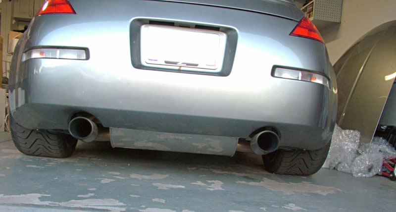

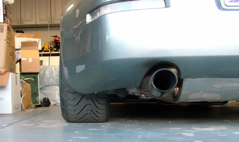

i'm expecting 8000 miles out of the rears if that
they work really well and are lightweight and have been able to hold the power in 1st gear with my vortech setup at my power level and 3.9 final drive and light flywheel/wheels/crank pulley etc
Attached Thumbnails Final Gear & FI-dscf6672.jpg   Final Gear & FI-dscf6683.jpg   Final Gear & FI-dscf6675.jpg
