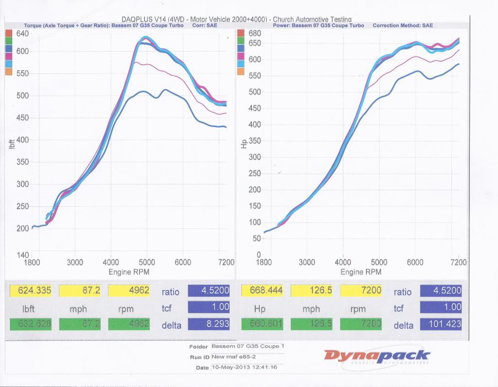

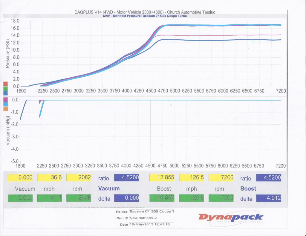

Minor update... changed MAF to GTM 1000hp MAF and also got a tune for E85

Old May 13, 2013 | 02:50 AM
  #141
herrschaft's Avatar
iTrader: (18)
Joined: Jul 2009
Posts: 7,739
Likes: 771
From: Coast
Nice. What did it put down with crappy 91?
Old May 13, 2013 | 10:48 AM
  #142
o__O's Avatar
Joined: Oct 2011
Posts: 115
Likes: 13
From: California
Didn't try to go for more power on 91 since I'll be running E85 all the time now
