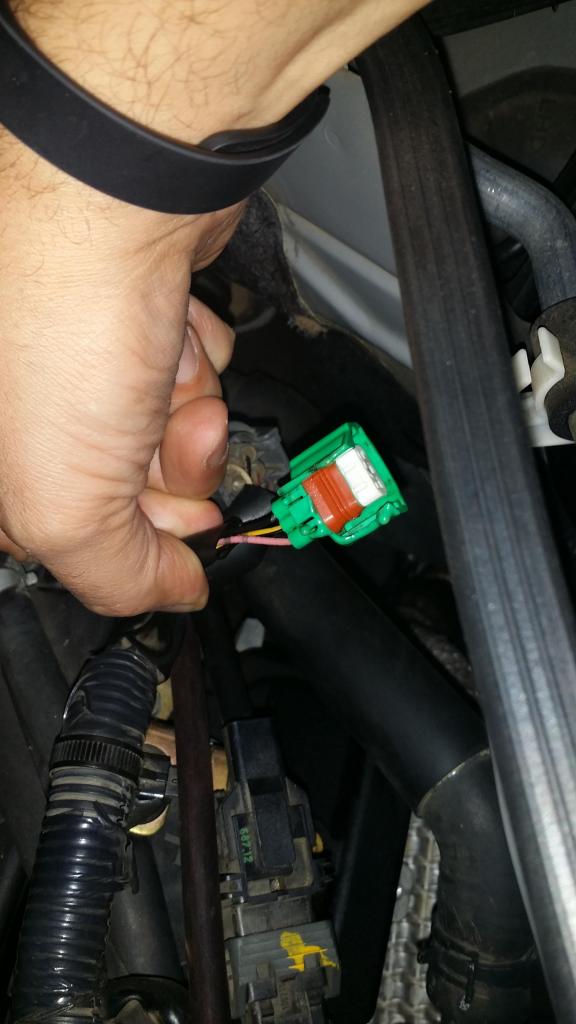

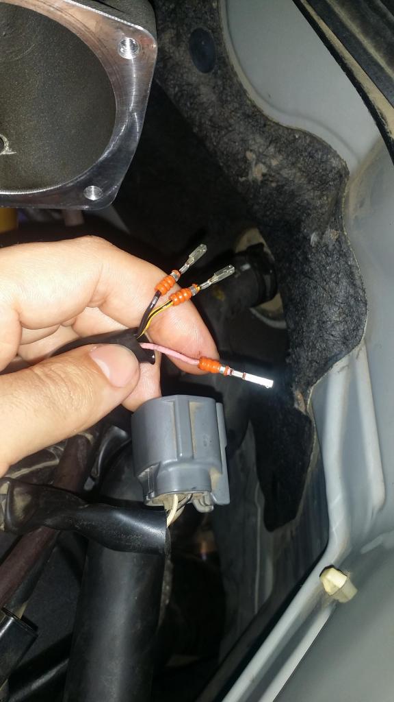

melted cam position sensor & plug
During some routine maintenance I discovered the wire harness clip for the driver's side cam position sensor melted. I managed to track down a new clip and bought a new sensor. But does anyone know how to de-pin the old clip? Trying to avoid cutting and splicing in the new clip.
pop the white piece off with a small flathead.
Look down into the pin hole from the sensor side. (not the wire side). You should see the plastic piece that snaps down to hold the metal pin in.
Take a very small allen key with a ball end and stick it in the hold and pivot the plastic piece up. Only takes small force. Pull the wire back at the same time.
Its very easy once you get the hang of it. Hard to describe.

Thank you!

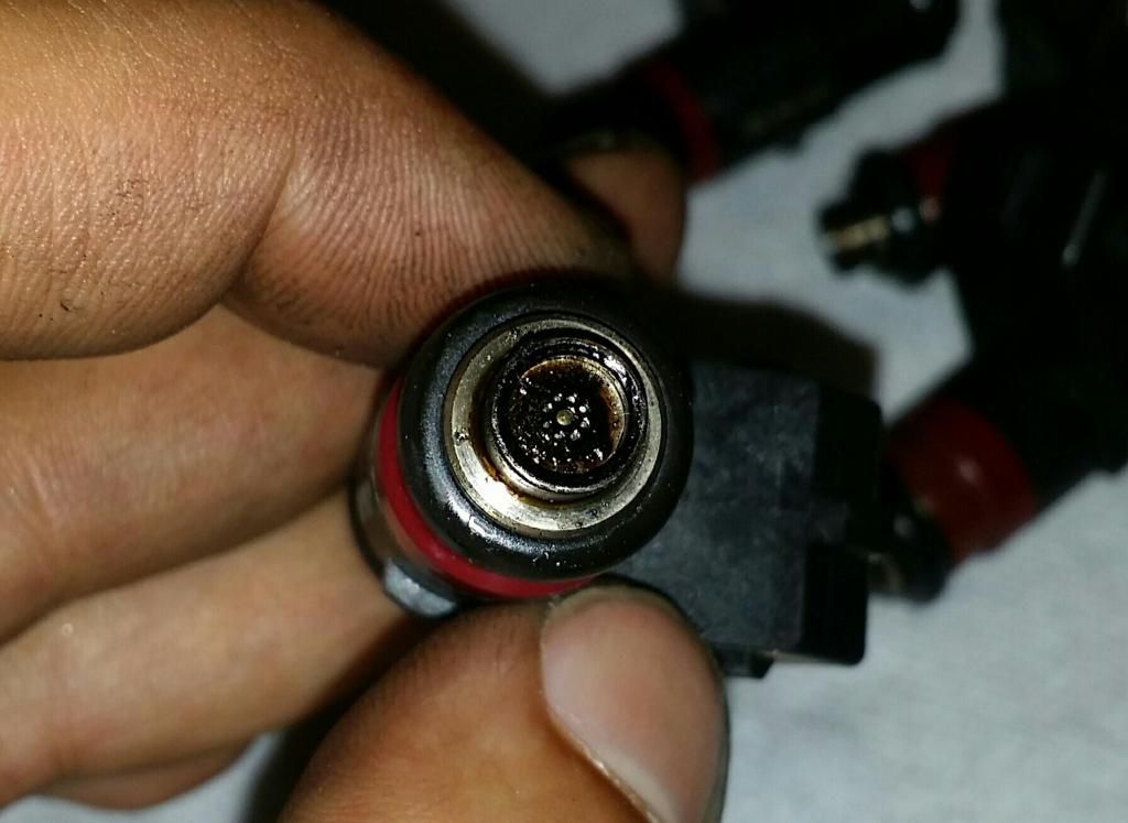

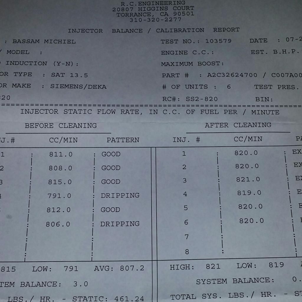

E85 users...
This is damn scary. Afr was starting to show a lean condition. So I pulled the injectors and was shocked
I sent them out to be cleaned
Once I had the injectors back I started looking around it seems this issue was somewhat common. And it seems the remedy is to occasionally run pump gas or an additive like seafoam. Anybody else have this happen? ?
Yea kinda when I converted to e85 the guy said to make sure to run 91 at least once a month because that could happen. He deals in subies and evos and said its a common issue wit e85. So whenever my afr show any sins of leaning I'll run a couple of full tanks thru with 91. So far so good for the last 2-3 years
