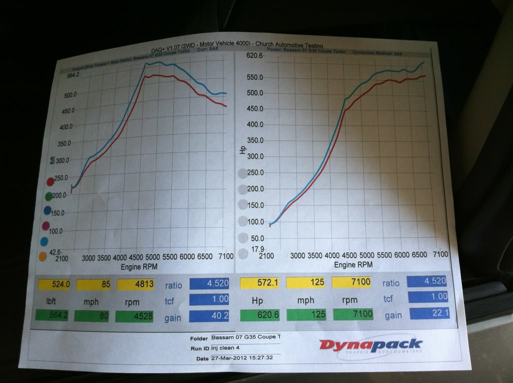

Good news. EVT control position sensors and EVT magnet retarders were swapped out and the timing has smoothed out. Now trying to trouble shoot engine knock at 12 psi. Running one wide band O2 on the driver's side bank. Its possible that we are lean in one or more cylinders on the passenger side (or even the driver's side...). Fuel pressure is good so the injectors are going to get pulled and tested.
Howard @ Technosquare, Shawn @ Church, and Marty have been working hard to help me get everything dialed in. More updates to come.

final #s are in...
572whp @ 12.5 psi
620whp @ 15 psi with 50% 100 octane and 50% pump gas

Wow, 100whp (16%) difference between a Dynapack and DD with identical kits, and boost pressures:
http://my350z.com/forum/forced-induc...-complete.html
Old Mar 29, 2012 | 11:39 AM
  #101
o__O's Avatar
Joined: Oct 2011
Posts: 115
Likes: 13
From: California
I came across Glex25's thread here on driver before. His car is a beauty! I don't think anyone here doubts that there are differences between readings from dyno to dyno. Or even pulls on the same dyno from day to day with the same car. A dyno is just a tuning tool.
https://g35driver.com/forums/forced-...-complete.html
