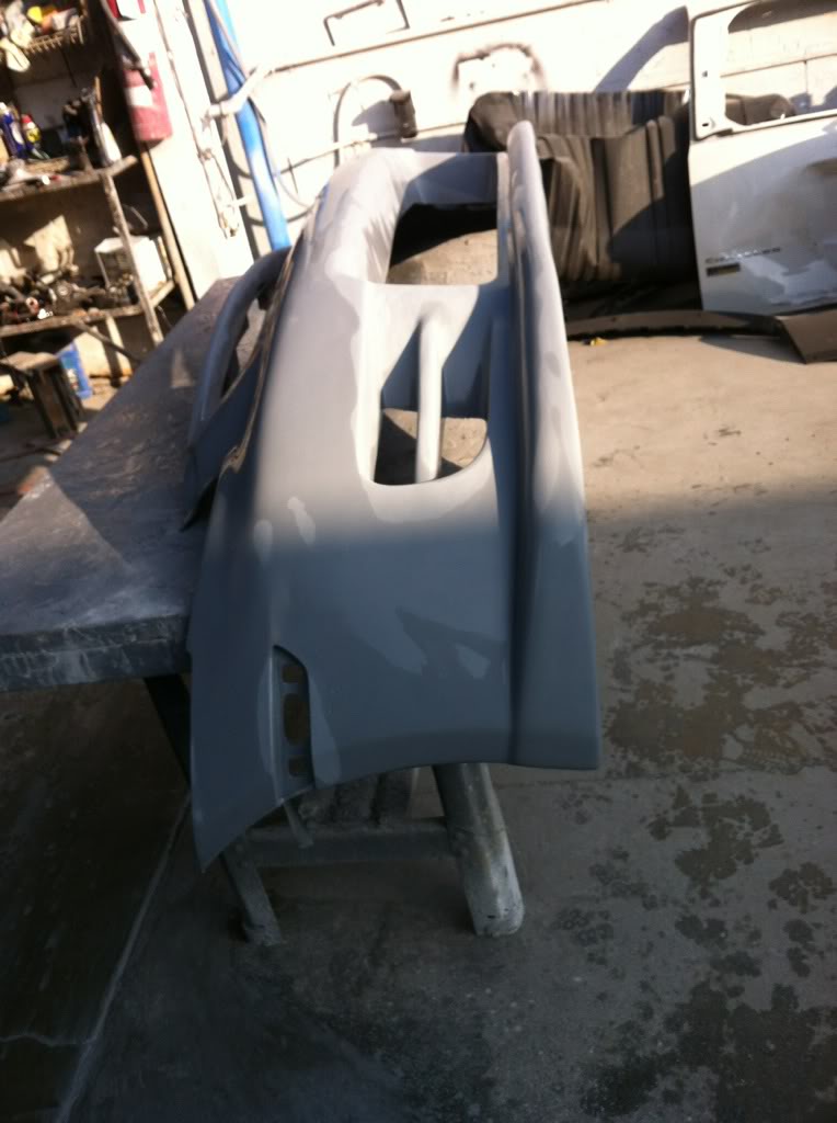

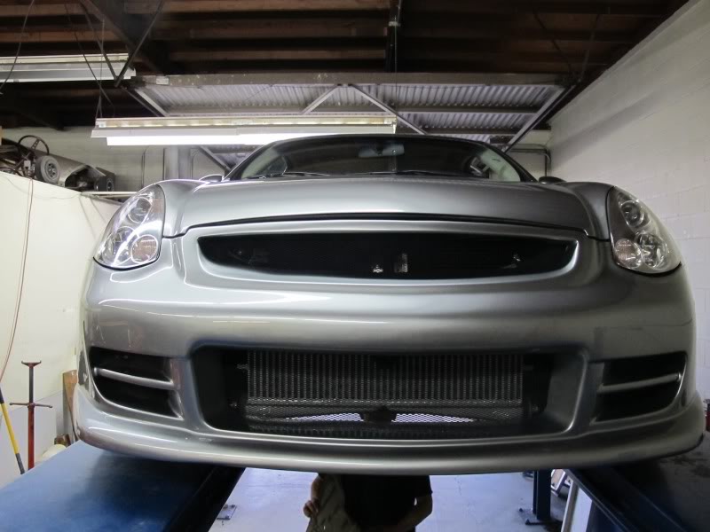

Latest update from Marty... bumper prepped and ready for paint. Auto Explosion does great work. From small jobs like this bumper to custom work!

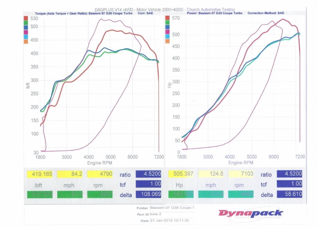

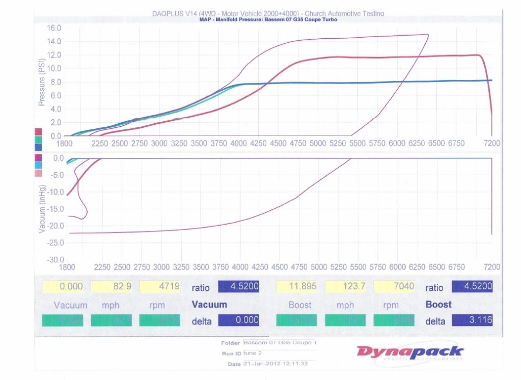

Small update to report. Attached below are the dyno sheets from Jan 21st showing a couple diff dyno pulls. One of the issues we had during that session was misfire in all 6 cylinders under higher boost (see curve for ~12 psi and ~15 psi). We tried to remedy that by gapping the plugs (ngk iridium) to .023 ... Today the car went back on the dyno and still getting misfire ONLY at higher boost like 12 psi etc. Pulls at wastegate 8.5 psi - no problems. I think the next thing we are going to try is just swapping out the plugs all together. Possibly running too rich fouled the plugs. Anything else you guys can think of please chime in.
Picked up the dyno sheets today as promised!

Update. I got new ngk iridium 1 step colder plugs and gapped them down to .023, did an ECU reset and still getting misfire under higher boost. At about 8 psi the car pulls through the RPM range without misfire. A third gear pull at about 12 psi, 6400rpm or so, hesitation is felt and I can hear it misfire. AFR is in the 11.5 range. There are no CEL/codes from the ECU.
Car will be going back to Technosquare to rule out any vacuum leaks, check fuel pressure, etc. We've also discussed the possibility of upgrading to Haltech.
Any thoughts/input?

We have ruled out ignition related misfire. I've had a chance to look over the data log with Shawn at Church Automotive and there is something strange taking place.
MAF
AFR
Intake timing R/L banks
are all reading/behaving as expected. However on the Exhaust timing we are seeing erratic changes in the timing for one bank only (can't recall if its R or L side) jumps +/- 10 degrees several times within a matter of a split second. Sometimes it does it under laod and other times we see it after a gear change. A spare ecu was brought in and reflashed without any luck. I believe this helps us narrow it down to possibly a bad EVT sensor, a bad EVT control magnet, or a bad/pinched wire. But again no CEL/codes other than recently a random misfire while I was backing the car out of the driveway (which may be from running more aggressive cams).
Correct me if I'm wrong but I think I was misinformed before about having misfire in all 6 cyl. I would imagine this would only cause misfire in one bank. And the misfire would happen only if the exhaust gas remaining in the combustion chamber was not allowing intake air and fuel to combust.
I really hope we are a step closer to getting this sorted out. If the above EVT solutions don't fix the problem is there a way to just disable the variable timing on the exhaust side - basically make it a non-revup?

Posts: 100
I have the same exact bumper in front of my APS twins...
Old Feb 28, 2012 | 12:38 AM
  #89
str8dum1's Avatar
Joined: Feb 2006
Posts: 1,241
From: raleigh-wood NC
^fitment looks poor at best. whats with teh gap between the bumper and the hood?
