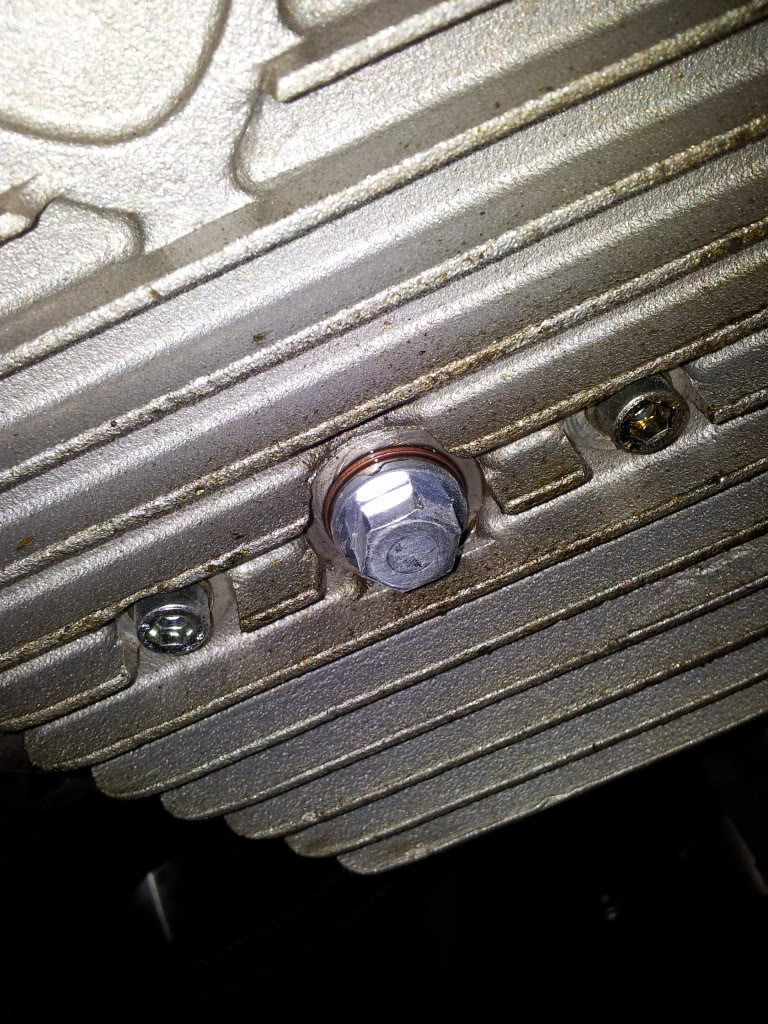

Yeah the oil pan drain plug is not completely sealed. But its not enough to actually drip on my garage floor (yet!). I've read that the threads strip very easily on the APS pans so im being very careful with it.

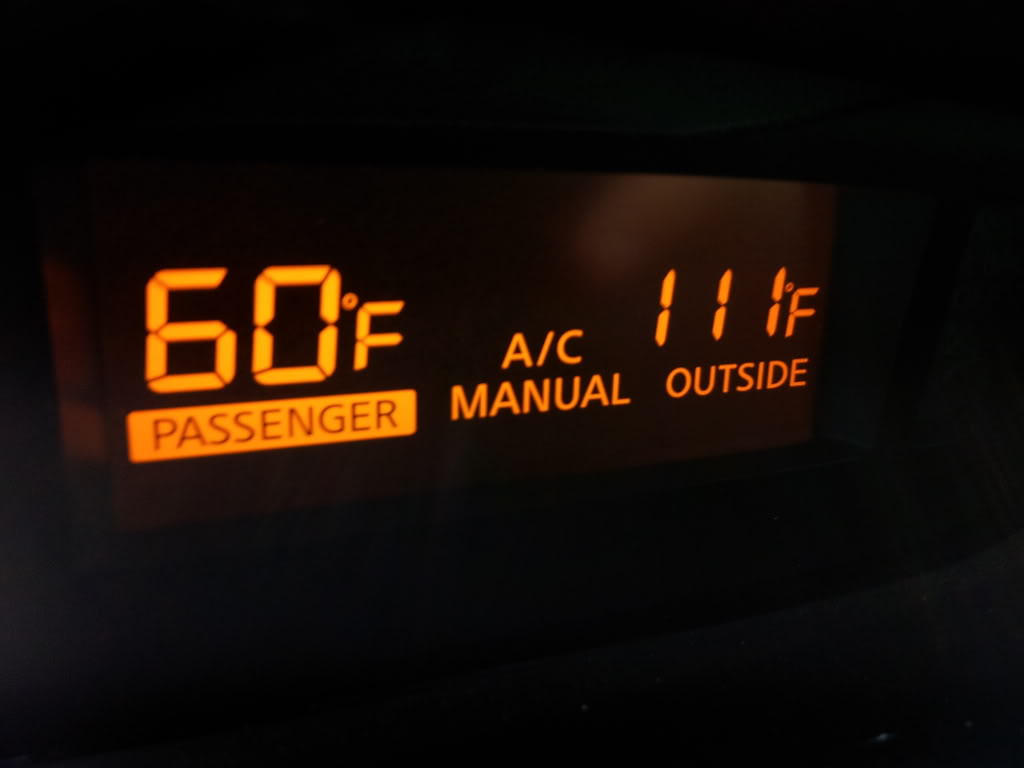

I've been meaning to give an update on the clutch pedal issue. So far everything seems to be working great. Stop and go traffic in the heat is no longer an issue, and we had a couple of days that were extremely hot here!

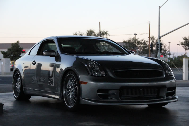

My buddy Houava took this rolling shot of the G. Not bad since he's only had the camera a few days

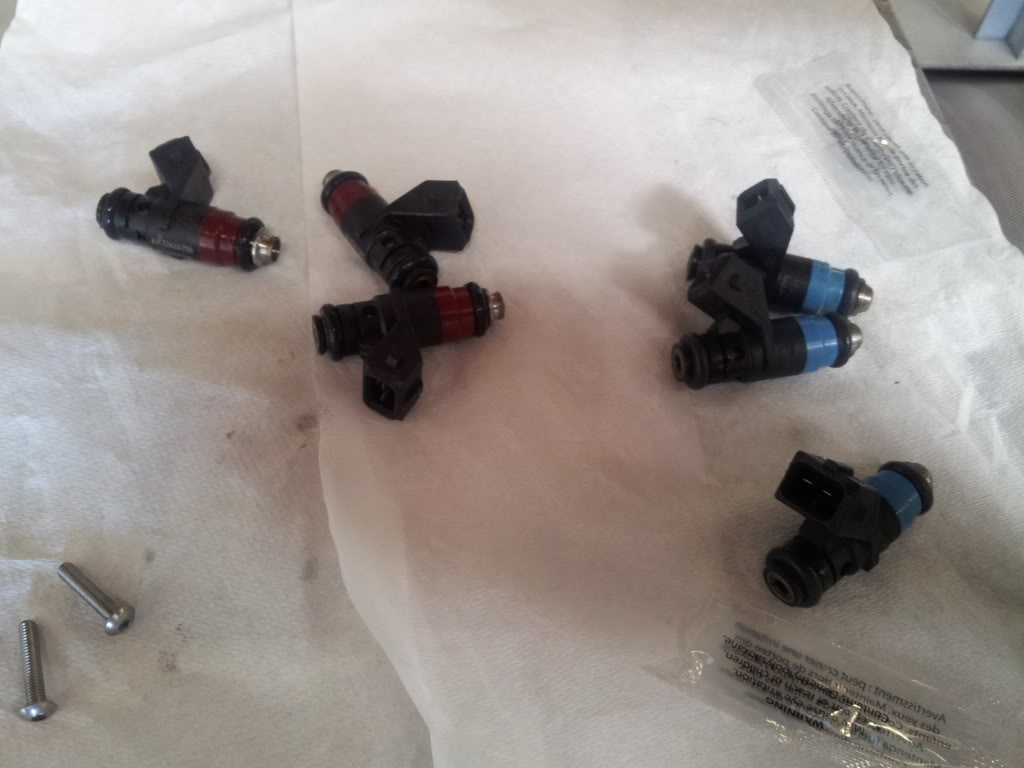

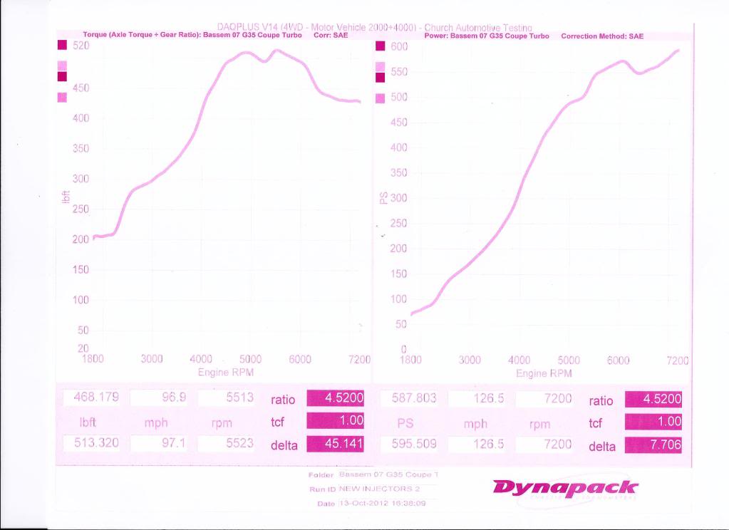

Originally Posted by o__O
final #s are in...
572whp @ 12.5 psi
620whp @ 15 psi with 50% 100 octane and 50% pump gas
APS extreme fuel kit supplied injectors (blue)...Upgrade injectors (red)
As others have said the GT MAF will max out at 600whp. It was reading 4.9v at these power levels. I need to think about what direction I will go in next...
Old Oct 14, 2012 | 02:42 AM
  #135
gabe3d's Avatar
Joined: Jan 2005
Posts: 976
Likes: 48
From: Bay Area, Ca
What size injectors did you get? You can upgrade to the GTM MAF, it can support much more air flow. This is what I have on my car. How much boost are you running in that last graph?
