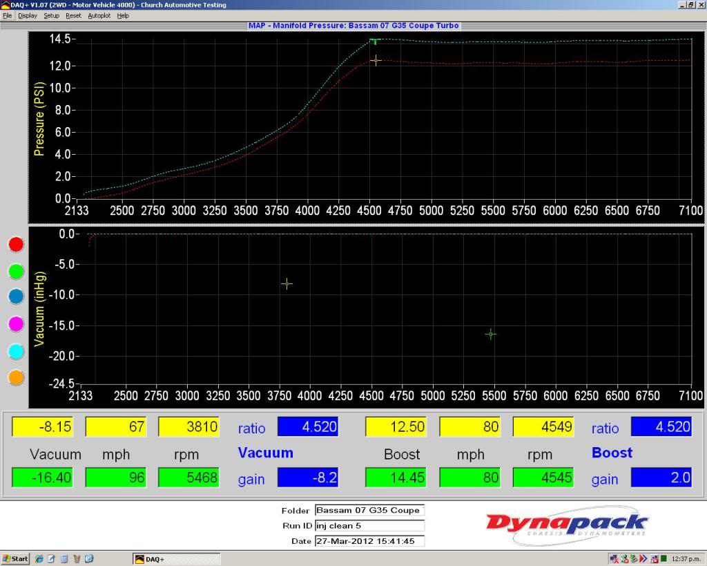

Originally Posted by str8dum1
The gtm gt35s with the biggest A/R they have is the only appropriate match for such a big motor.
+1
btw my aps extremes reach target boost at 4500 rpm. when would the gtm gt35s w/biggest A/R reach target boost?

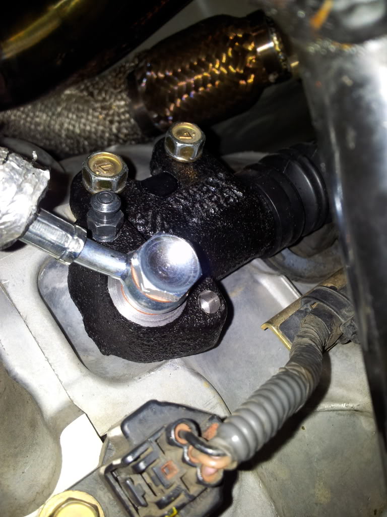

Other members have described driving the G to that of a bucking bronco and it was the one thing that I always hated about the car...Well I finally had some free time to take care of the dreaded clutch problem. Got the new master cyl, slave cyl, SS clutch line and rbf 600 in. My initial impression after a 15 min test drive is that there is a huge improvement in clutch feel. Its a lot more linear now and predictable. BUT...the true test will be how it holds up in stop and go traffic in the heat.

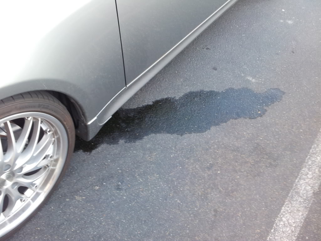

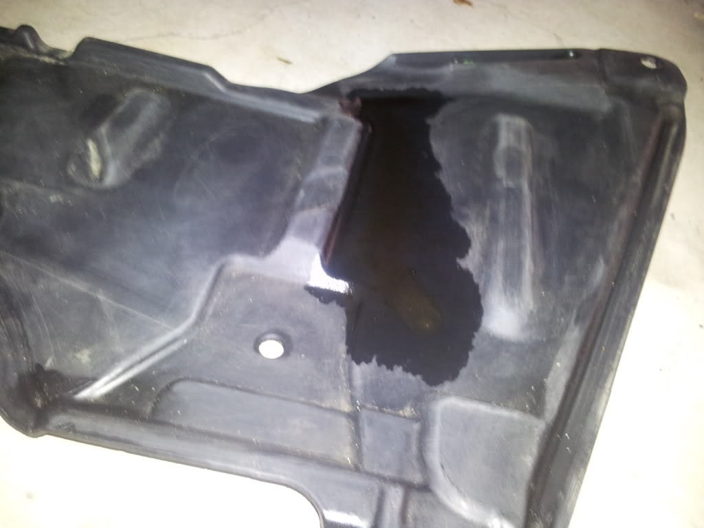

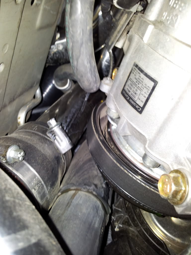

On to some other FI related issues. I found that the A/C compressor was rubbing against the lower radiator hose. I discovered this when I went out to the car one day and found a puddle of coolant under the car.

That was an easy enough fix with putting in a new hose and tying it down to the turbo compressor outlet duct. Hopefully it won't wiggle its way back to the A/C compressor.

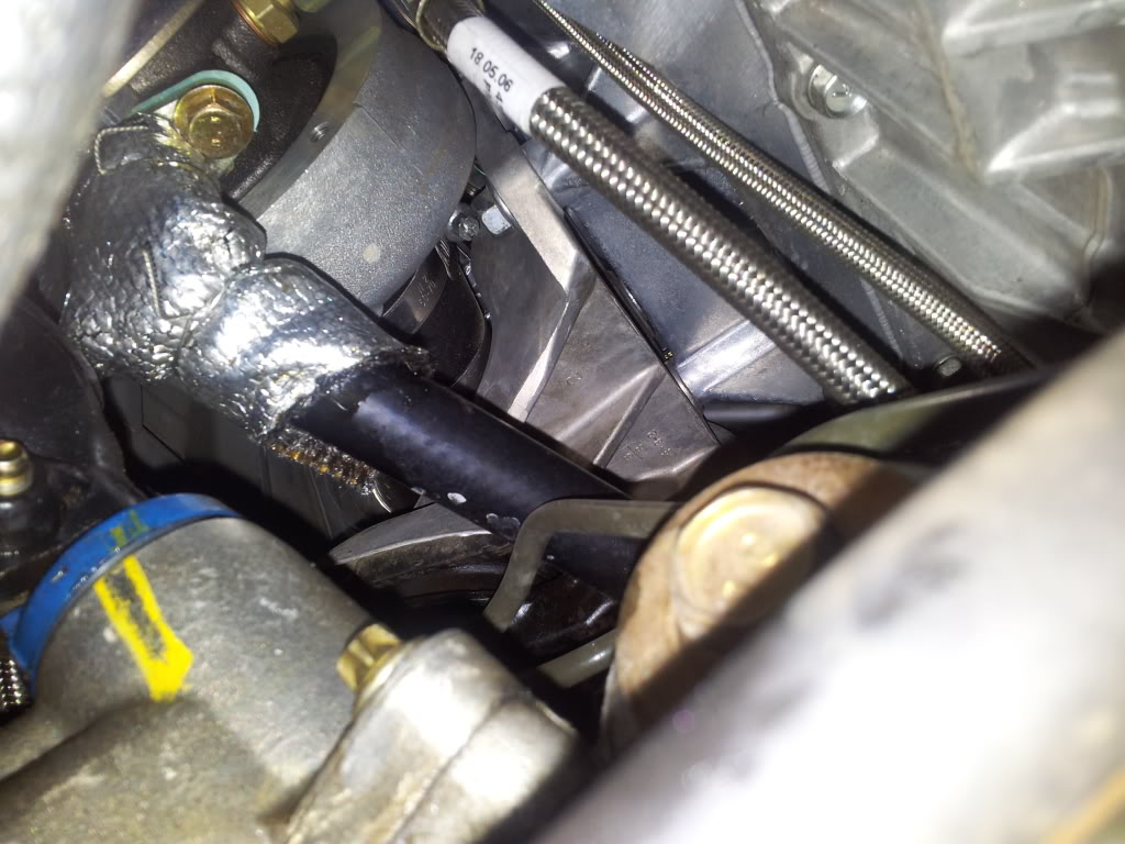

Also discovered an oil leak. I've been keeping an eye on the oil level and didn't see any drop in the level but I found the leak when I was under the car. After wiping everything down and running the car in the garage I was able to trace it to the driver side turbo oil return. I guess the supplied hose clamp just wasn't doing the trick.
Its not the greatest picture but you can see the oil starting to seep under the heat wrap that was placed over the hose clamp.
