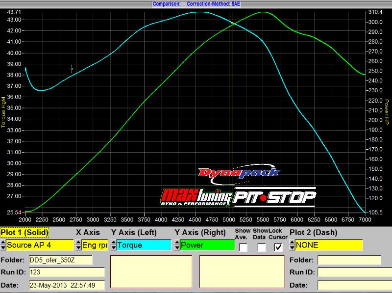

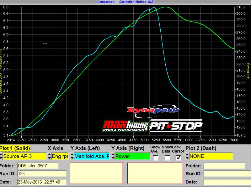

M62 Stillen supercharged 350z - boost drop over 5500 RPM
Dear friends,
I own 2005 rev-up stillen supercharged 350z,
Lately i started to hear strange noise that is coming from the supercharger above 5500 RPM,
And when we tested the car on the Dyno i got the approved that the noise and feel above 5500 RPM is big boost drop...
Please check the Dyno video where you can see and hear this issue,
Any idea on what is the problem ?
Could it be the a slipping belt ?
Thank you,
350nis.

It could be a slipping belt OR it could be head lift if your on your stock block. I blew my engine on this SC because of head lift. Boost was getting too high from what I was told that the stock block could handle.

Posts: 160
Likes: 9
What was your boost poundage? I've only ever been able to get 7lbs in my set-up - with a daily average of around 4.5 or so.. but I'm doing a pulley bypass so I get slippage above 5500rpm :/ And I'm pretty certain my levels are way within safe for the stock internals. Isn't the Stage 4 only possible of around 12 or so?
If it's higher - man I'm doing something VERY wrong! ;B
