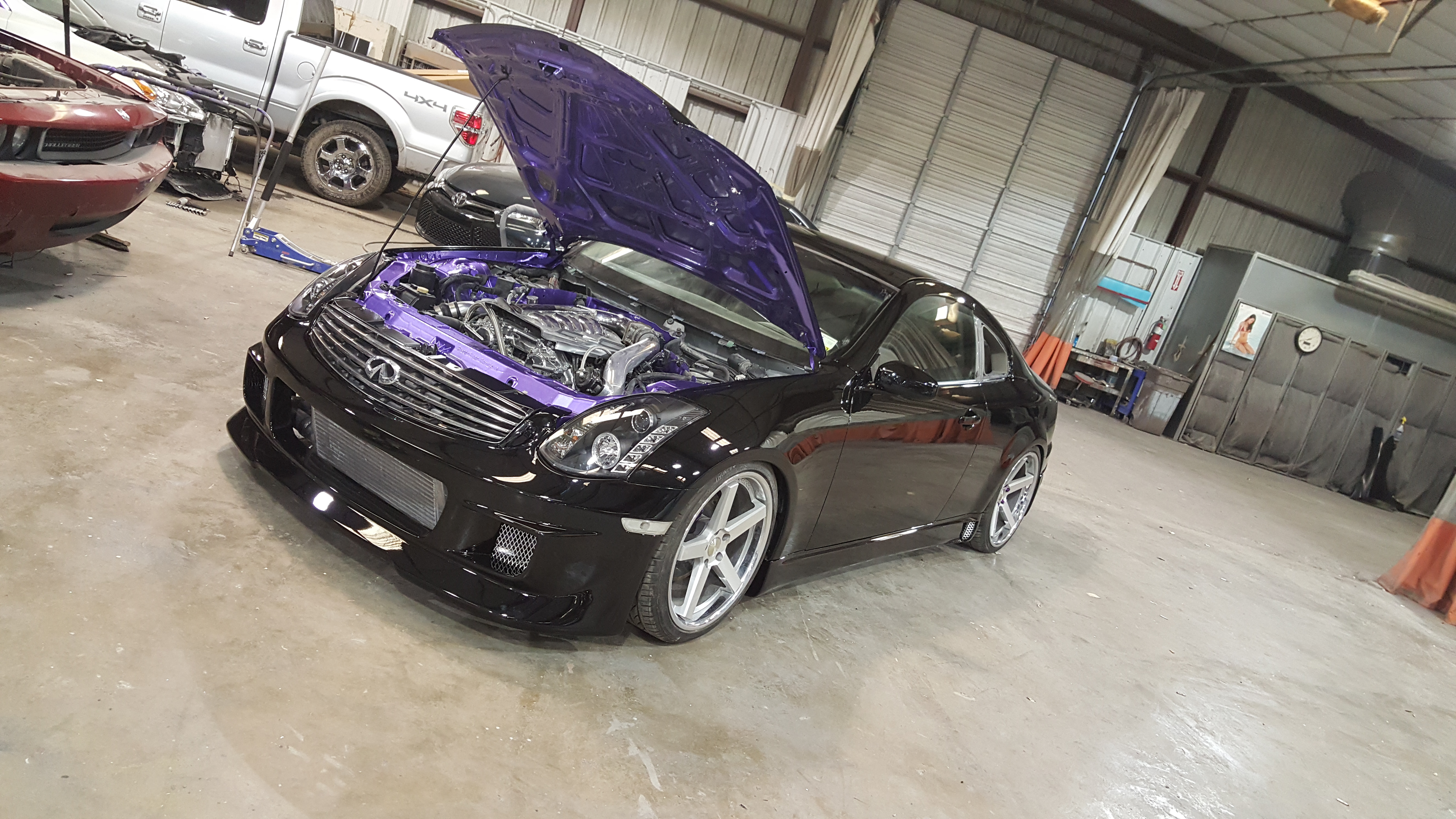

Ok fellas... i have a 06 g35. Twin turbo, built motor. I was driving this weekend and car lost power n died. Battery died pretty fast afterwards as well. Ive been trying to troubleshoot this all week and its driving me crazy! I found that i wasnt getting spark anymore. Tiny spark every so often. Fuel is good. Checked all plugs, cylinders, and coils... all good! Checked fuses by driver kick panel. Replaced ipdm. I also Have a big deisel truck battery spinning it over fine. Still no constant spark! Reflashed ECU.
Alarm system, NATS is ok. I replaced both cam sensors and crank sensor also. Still no spark!
Please help guys!

Im so disappointed.
