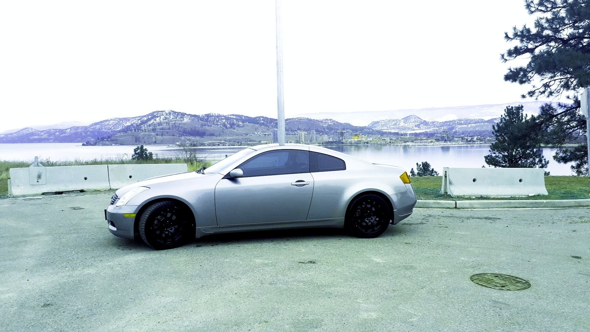

just a question for you. What km intervals are you doing oil changes ? I see no oil leak on this but i do have what appears to be water coming from the tail pipes. Maybe im just burning so much oil because of the oil amd driving hard! Anyway wish me luck going to swap this oil . Did a 2 hours inspection jacked up i got nothing dripping. Oils gottOriginally Posted by cleric670
