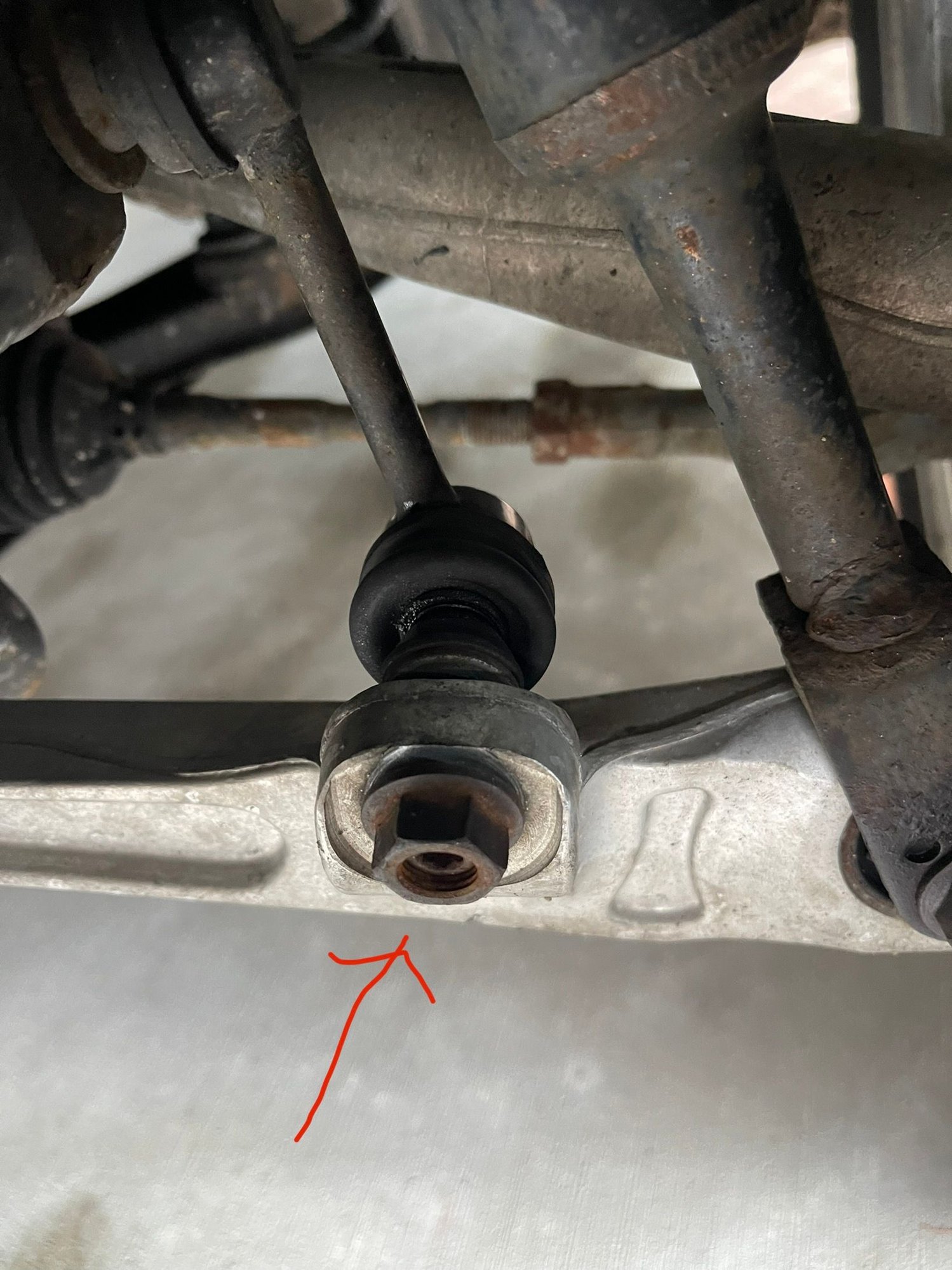

So I got my rear coilovers on today and I absolutely love how they look 😍 , but got stuck on the front ones cuz there’s a loose strut bolt that I don’t know how to get out…does anyone know how to get this bolt out ??

That's your sway bar* end link, on the inboard edge of the stud it's flattened off where you can put a spanner wrench in to keep the thing from spinning.

That's your tie rod end link, on the inboard edge of the stud it's flattened off where you can put a spanner wrench in to keep the thing from spinning.
Really hoping that the bolt isn’t seized in there 🤞🤞but we’ll give it a shot! Thanks for the advice !

Lol yeah sorry, SWAY BAR END LINK I had it half right.
