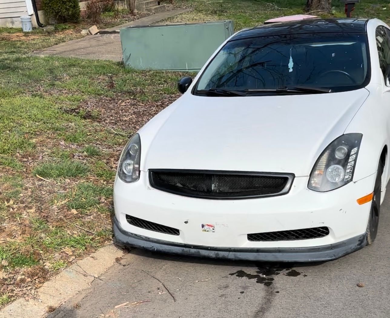

Hey y’all bought my first g35 thinking it would be a decent car turned out the guy scammed me but it’s whatever just got completed with a engine swap and now the car has no spark no fuel and I’m unsure of what to do replaced cam and crank sensors and fuel pump! Any help is appreciated!

Grounding wires are all hooked up no security lights I have spark now no fuel all parts used from swap not original car no idea if tach moves or not currently taking fuel line out to inspect for kinks
