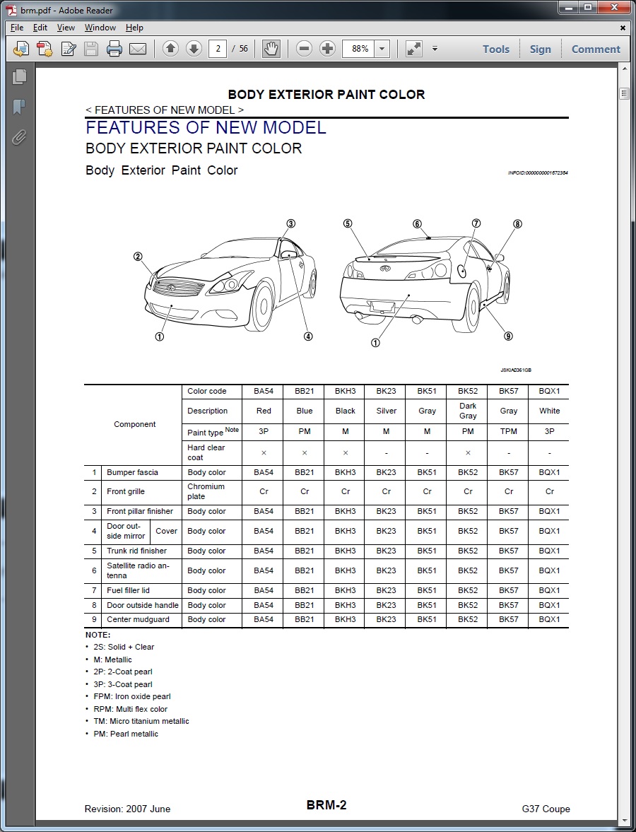

Correct, it is well known to be very poor quality, but it is multi stage.
I found the paint info for G37s. I dont have the G35 info on hand, but it is similar.

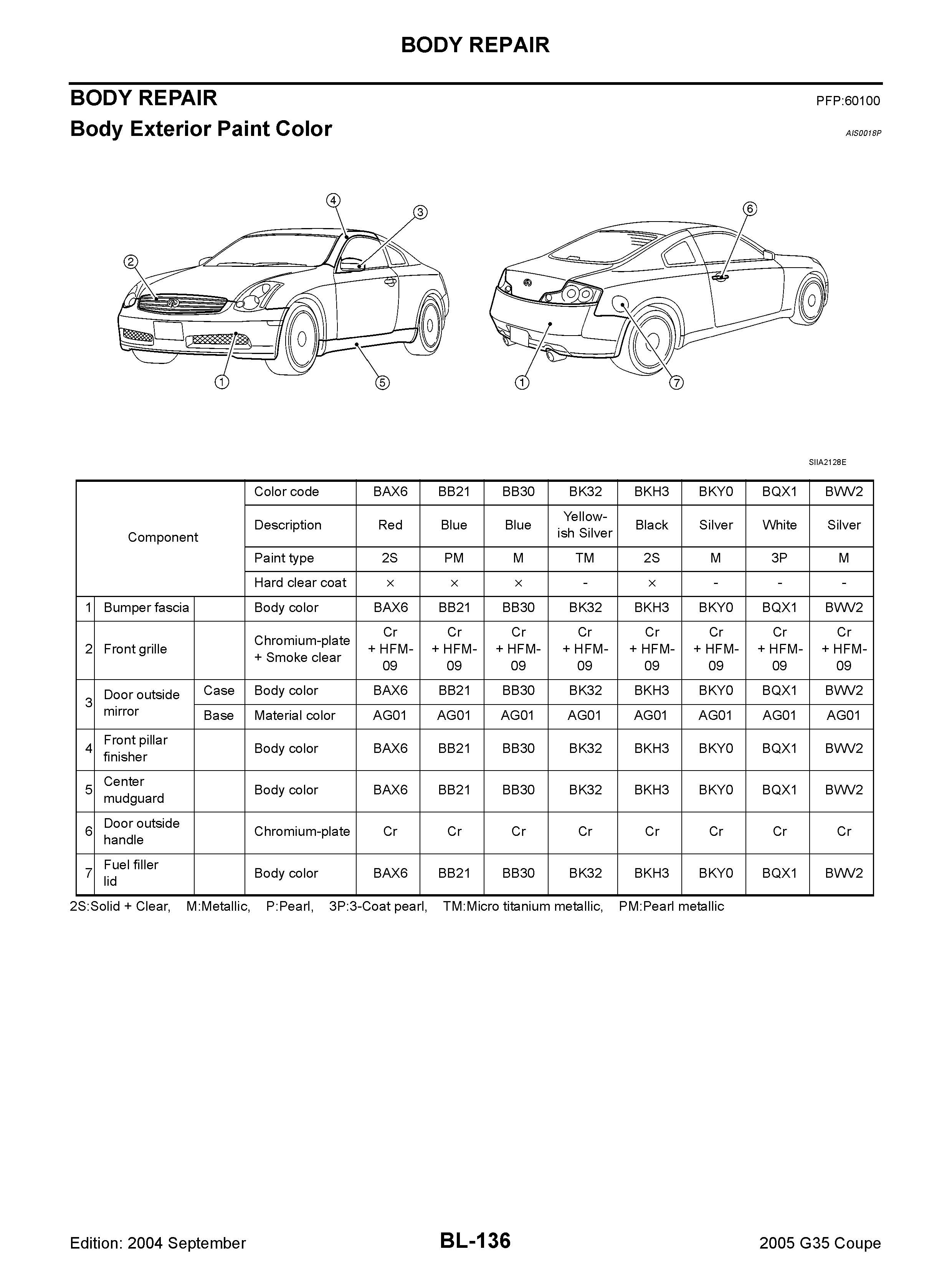

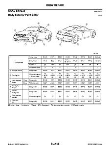

Found my service manual for G35. Here is the G35 paint info.

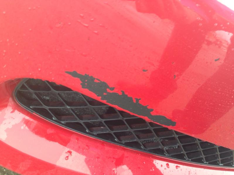

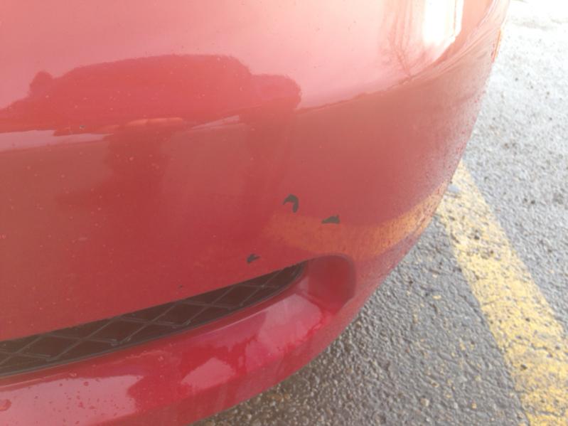

Well... Aparently shell car washes double as paint strippers! Thanks Infiniti, you're making me regret buying this car more and more.
Attached Thumbnails Well... Shes being painted-image-3103238426.jpg   Well... Shes being painted-image-295235784.jpg

I've never seen that happen before. I would be willing to bet that your front bumper had a cheap respray done prior to you purchasing it.

I actually have known the old owner since he bought the car new, this is all original paint.

Regret is that you made bad choices where you got your G washed!

You should be blaming yourself for running your G35 thru some chicken **** car wash that uses brushes! Don't blame the car, it's the drivers fault!

It was a touchless, but ok. That's all that was open and the car was covered in salt.
If a car can't take a expensive touchless carwash... Well it's garbage.
