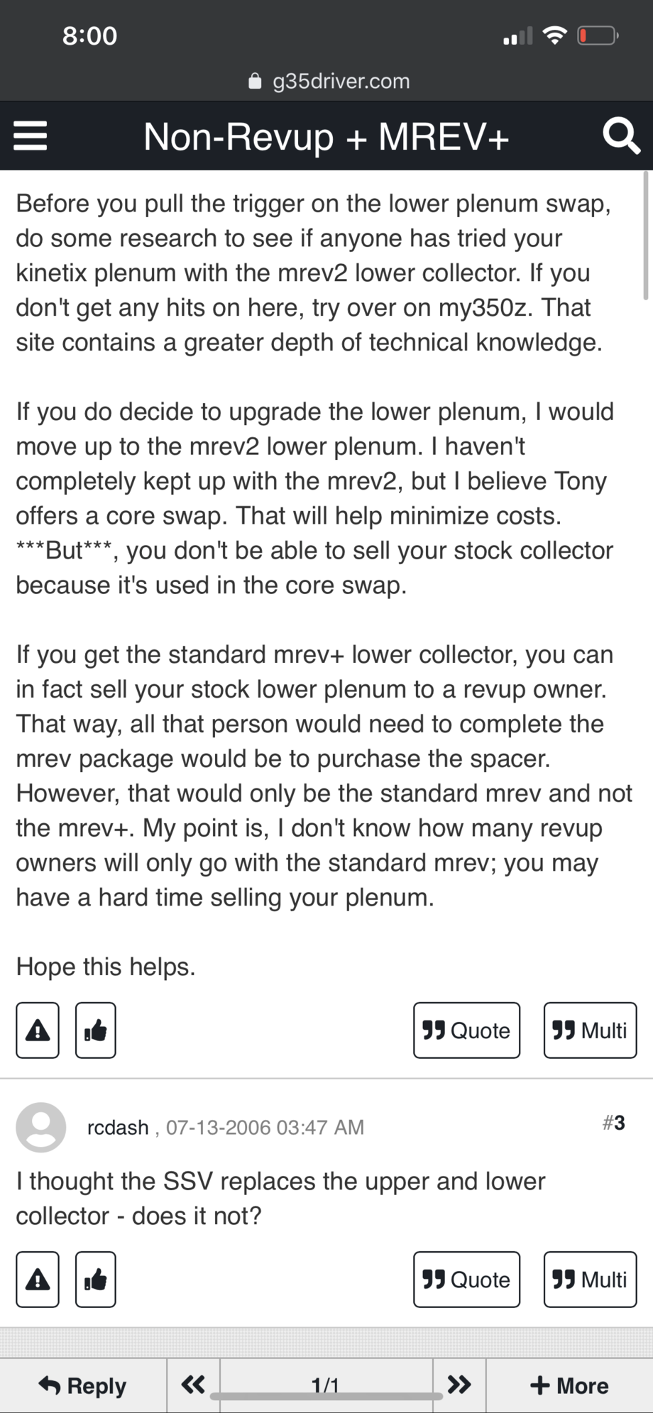

I had my suspicions but wanted to find someone who actually dyno'd the combination before I posted.
https://g35driver.com/forums/g-spot/...-manifold.html

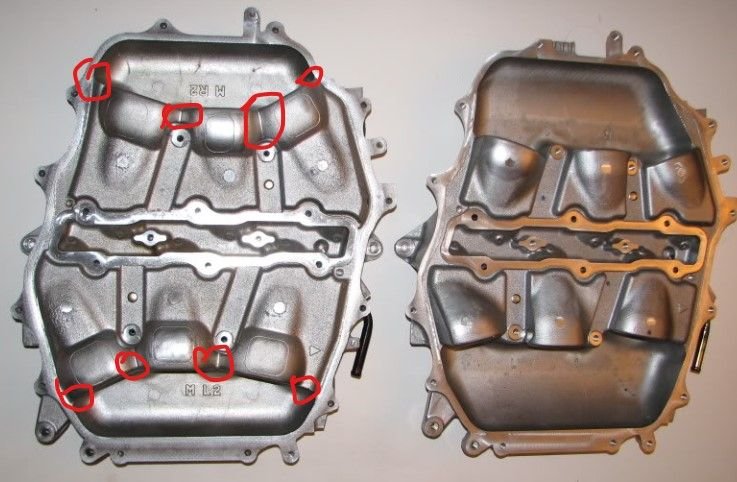

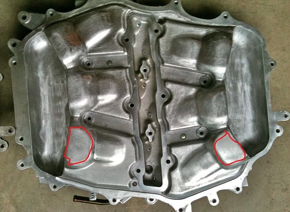

Basically you pick up the mid range torque but the engine falls flat on it's face after 6k. Even a mild do-it-yourself port job to clean up the top of the rear runner and smooth off all the rough corners would pick the upper back up again though. Too much turbulence in the stock plenum and you NEED to smooth everything off to keep it flowing smoothly at high velocity.
Basically if you hit all these circled spots (non-rev plenum on the left, revup on the right) and smoothed/rounded them off REALLY WELL then you'll pick up bigger top end gains on the non-rev plenum. When the air hits a sharp edge it creates turbulence so you want everything rounded off as well as you can.
Thank you very much for the info and pics I really appreciate it. Tbh I don’t really like revving my engine pst 6.5k anyways so that sounds perfect, I came from 9k Honda’s but it still makes me hesitant on my G lol.

The best thing to keep in mind when porting, imagine you are quickly pouring WATER into the plenum, you want the water to roll smoothly off every edge, if it creates a little "waterfall" on the edges then it's going to create turbulence.

If you want to remove even more material the front two runners can have a little more than 3/16" material removed from the top. You can use some play dough and a calipers to measure the gap with your spacer and upper plenum in place. Make little ***** of play-dough, stick it to the top of the intake runner, put the spacer and upper plenum on, remove, measure the height of the play-dough ball. You want them to all be the same and there is less clearance on the front two runners, the slope of the upper plenum causes less clearance in the front so basically you just even it out.

It took me a min to visualize what you were saying but now that I can see it that’s a great idea. Just to clarify the runners being the red circled portion that the air “runs” over, right? Or the opening where the air goes down into the collector? I’m sure I got it because it makes total sense. So just to clarify all I have to really do is smooth out those edges and that makes it MREV basically?

So the runner is the 6 holes that air travels down to go into the manifold below it. The top of the front two runners have less clearance to the top of the UPPER plenum because of the slope of the upper.
Circled the area on the top of the runner where material needs to be removed. Strongly suggest using the play-dough and calipers trick so you don't remove more than necessary.
This guy went a little overboard removing material from the top of those runners, looks more like 1/2" removed, it's all about balancing the airflow so you want the gap between that point and the upper plenum lid the same (or close) across all runners so you have even airflow.

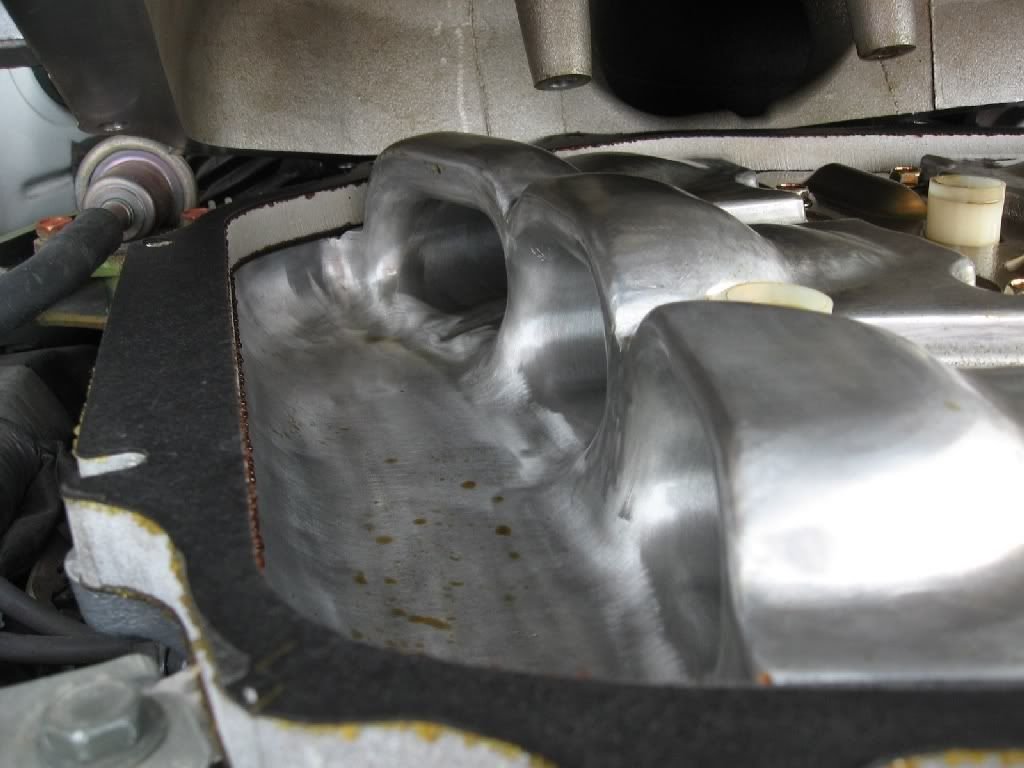

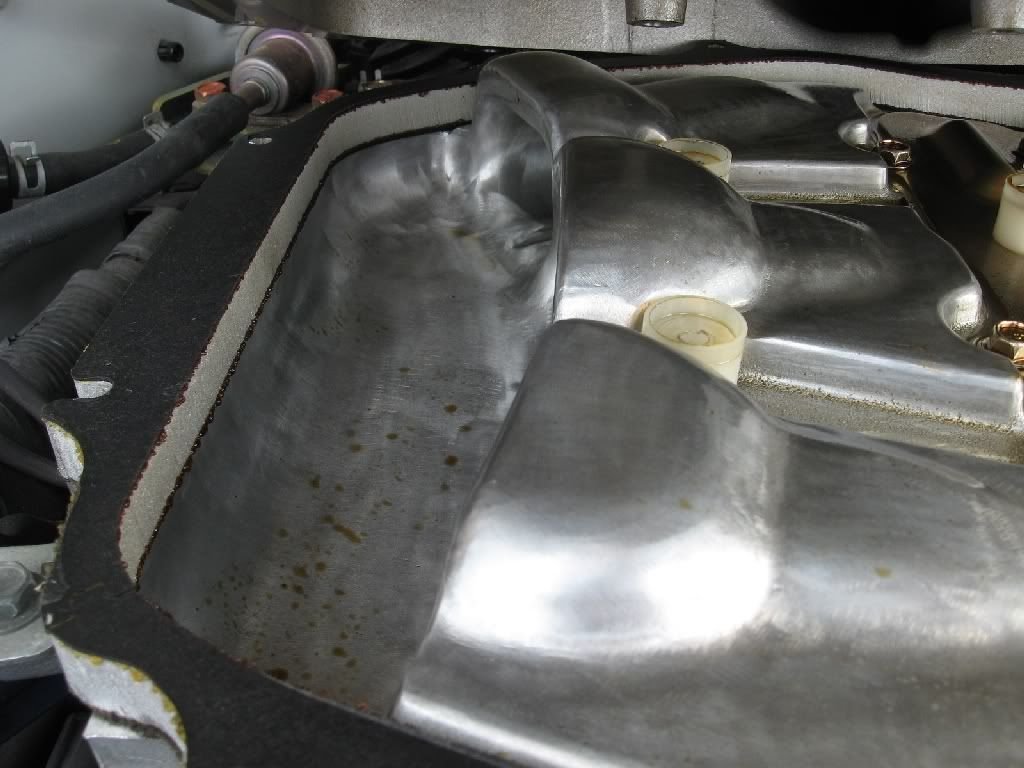

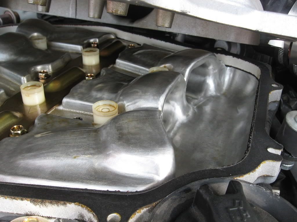

Here's some pictures that I found on MY350Z of an intake that Tony (Motordyne) confirmed was an actual MREV2
hey thank you so much for all the info! I’m picking up my non revup upper and lower plenum this weekend to start the work!

Keep in mind that particular intake was a FULL POLISH that the customer paid extra for, typically there's not that much work done to it, just the reshaping of various areas and the lowing of the front two runners.
