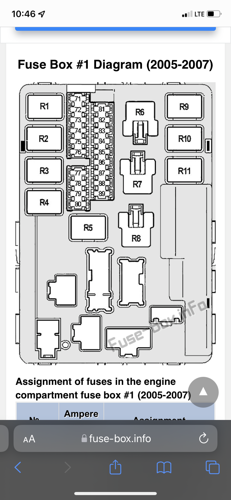

The white light on the spec d headlights isn’t working, but the turn signals are and so is everything else on the headlight. My side markers also aren’t turning on. I’m guessing a fuse is blown, but which one. And if it isn’t a fuse what is it.

Check fuse #71 on the ipdm.

the fuse looks good

Do you have ANY of the parking lights working? Including the ones in the taillights?
If literally ALL the parking lights are non-functional it could be the internal relay in the IPDM has failed.
If everything worked fine before you installed the Spec-D headlights then that's probably not the issue.
Also check fuse 78 in the IPDM, don't just do a visual inspection, use a DMM and actually measure for voltage while the fuse is inserted by probing the back of the fuse on it's test lead points.
